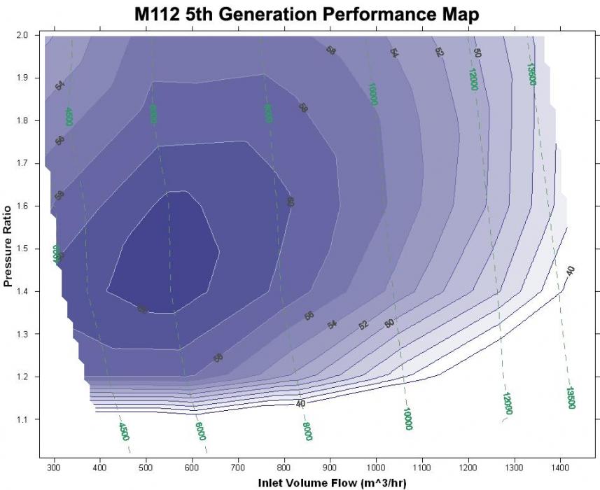

George;
Do you know if any internal engine parts are forged or not? I have never found out if there is any difference compared to the standard non-supercharged 4.2L. The only difference so far is the reduced compression ratio to 9.8 from 11.5. This is done with different pistons so I think the rods and crank are the same?? Brutal has verified that the heads are the same and the exhaust manifolds.
The VVT was not added to the STR until the 2006 and up model years. There is also a mention of a pulley change around 2007 to increase the power to 410 HP. I have not been able to pin this down any better??
We almost have the largest Eaton at 112 cubic inches. There were also different generations of the M112. The STR has the best and latest Generation V(5) of the M112. The generations vary in compressor maps and bearing packages. The Eaton is favored by car manufacturers because of it's very long life and lack of problems. Even though there are more efficient units out there. The new XFR now has a variation of the twin screw as does the massive LS9 in the 638 HP Corvette.
The STR does not have the largest Eaton blower. There is a M122 which of course is 122 cubic inches. This unit is only used on the 2007 and up Ford Shelby GT500 Mustang with the 5.4 L that makes 500 HP ,480 Ft-LB. The Mustang guys regularly replace this with a nice TS kit that is available for that application. Lucky guys!!! This M122 was made with some special castings on the intake side to match the Mustang and I don't think we could adapt it to our cars.
Here is the compressor map for our Gen V Eaton. You can see why spinning this thing faster will only give so much extra power before that is overwhelmed by the additional heat of compression.

Now don't forget porting and reshaping of "special areas" will change the compressor map. An eaton specialist is eager to help us get more out of our stock blowers. But I need to bring one in for him to put on the flow bench and find the tweaks for our casting since it is different from the ford casting. That was one of steigmeirs mistakes, According to someone with over 25+ years of eaton experience said they casted differently internally and cannot be treated as a ford blower. Porting it wrong and rehearing it wrong will actually cause you to lose power as the rotors become unphased.
When they are out of phase (time) the air collides within the blower. Causing more heat and extra power consumed to turn the blower so you end up with a power robbing noisy monster.
