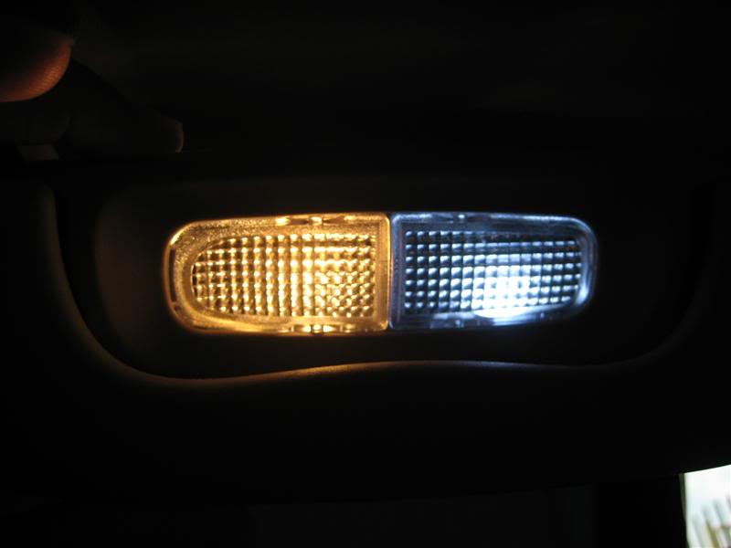

Default Rear Map Light update with LEDs
I didn't see any pictures posted for the rear map light change, so here are a few from my update... I hope this helps someone!
There are two little flaps you need to pry open with a small screwdriver to access the #20 torx screws.
Here is a shot of the screws behind the flaps.
The whole unit pulls down so you can access the bulb sockets. Just twist them and the bulbs pull out. Very easy!
Plug the LED into the socket and reassemble.
Here is a comparison shot of the starndard bulb vs the LED. BIG difference! I think this is one of the easiest things you can do to update the look of your car... Enjoy!
