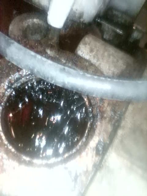

I got the pressure tester and found leaks on the water pump and the passenger side of the radiator, which was weird as I've not seen any moisture at the front until today, maybe it just evaporated, it was a slow leak. I still could not identify the source of the leak at back of the engine. I took off the top manifold and the top of the block is wet at the back near the firewall but not forwards of it. There was a round depression on top of the engine in this area that seemed wet but I couldn't really get to it. I took a bad photo with an endoscope but I'm not sure if will help lol

Great work! Sounds like you are hot on the trail. Fix the known leaks and then test again. Who knows, maybe coolant was getting blown on top of the engine and collecting there.
