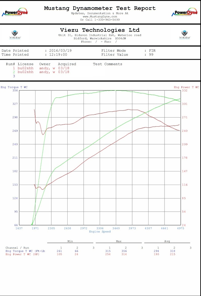

Default I have both graphs now
Old Mar 22, 2016 | 01:04 AM

I can see graph just up to 5,000rpm - where is the rest 1K?
Old Mar 22, 2016 | 03:43 AM
  #53
rd350ypvs1972's Avatar
Joined: Nov 2014
Posts: 72
Likes: 12
From: cumbria
That's all I have received
4.2 with Gen V Eaton should rev well up to near 6K even with smaller upper pulley. If they really have missed last 1K, you can expect 25-35whp more than @ 5K. I would ask this from Viezu if they have any reason for the odd rpm range.

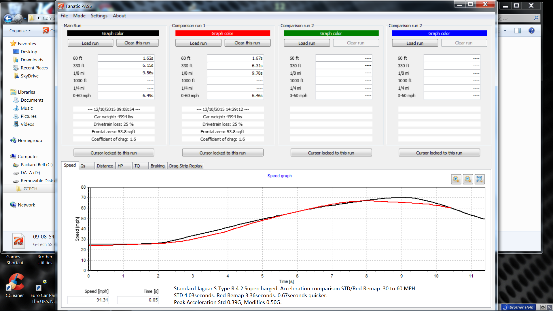

Check out the before and after graph for my standard STR after it was remapped, yes you can certainly feel the differance.
I also added a 10% top pulley on a customers car and again there was quite a differance.

Talked to the engineer who dyno'd my car, here is his description of the graphs
Hi
We have had many of these on the dyno that have done similar on the RPM as the gearbox is always trying to upshift above 5000rpm which screws up the readings if the dyno reads the data through the shift.
The graph is showing an increase of 40ft lbs of torque and 60hp
The 60hp is a little higher than expected as the stock car was running warm on the original runs at the top end so the Original power tapered off a little earlier than normal.
The gains corrected for temps etc would be approximately 45-48hp which is what is seen in the midrange.
