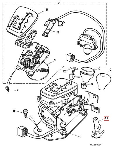

  #68
clubairth1's Avatar
Community Influencer
Posts: 12,073
Likes: 3,361
From: home
A couple of things. I agree with the other posters. The transmission is exactly the same from 2003-2008. So they are just plain wrong on this.
Next the switches I mentioned above are position switches. So no real neutral safety switch just multiple micro switches that tell the computer what position the shifter is in. In fact there are multiple switches that are exactly the same. They are easy to replace and should not be very expensive. The prices that have been thrown around are for the entire shifter. Which is not needed. Of course Jaguar might not service the switches individually but they are removable.
Don't get too scared the console is very easy to take apart. The shifter is then simple to unbolt to work on the bench. Again there should be very little labor for this.
Here is an exploded view of the shifter and it does not show the micro switches so Jaguar will probably say total replacement is the only cure?? If so consider a used unit. Remember that your failure is so far the only one I have heard of so I would trust a used unit.
Please post back the part number of the piece replaced. It would be a help!

From: home
Hope you did not need an new shifter as that's pretty expensive!
I am hoping they replaced item 4 in my exploded diagram. That piece may not be too expensive. But it may require item 3 instead?
