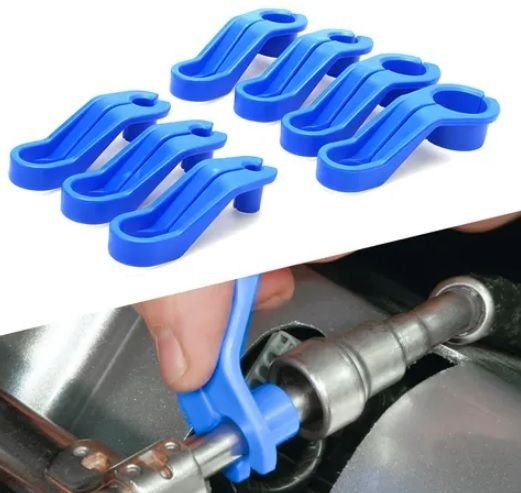

Just remembered something: If you plan to swap the fuel filter, while the wheel arch liner is off, it would be an annoying experience to have all the parts at hand, but not being able to get the old fuel filter off. These are very handy tools for that - very cheap and they seem to have them e.g. on Amazon:
