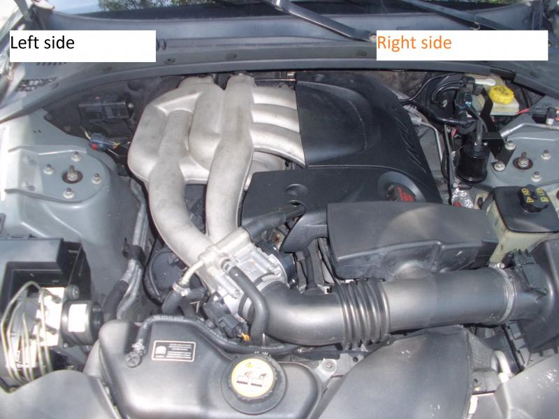

Hi again, I Just brought the Ho2 sensor can you please tell me by looking a the pictures which side is the sensor located on the motor that throwing the check eng code P1646
Attached Thumbnails Found some problems with my new purchase-cimg0024.jpg   Found some problems with my new purchase-cimg0025.jpg   Found some problems with my new purchase-cimg0026.jpg

Don't know the engine well but I can say you have Left & Right swapped in pic #1.
All directions are as if standing behind the car looking forwards.

Pic 2 and 3 pic are the same picture just one is in focus more also that the left side of the motor.

Your passenger side is the right side as JagV8 mentioned. Pic 2 and 3 would be the sensor that is supposedly bad.
