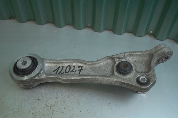

This is one of the arms which are £140 each at the cheapest for new.
The middle bush is the lower shock bush.

Exactly the same arrangement here. That's a really useful shot and I wish I had seen that before, so thanks for posting. I spent hours looking for a photo or video showing the front lower rear arm on the car. With the old rusty bolts I think its best to cut them off which is what the mechanic does on my car. He has asked me to get a full bolt kit from Jaguar which Jaguar priced up for me at £40 the lot for the 2 x lower suspension/control arms.
