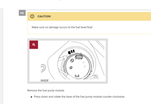

Finally I got a new pump, removed fuel line, electric connector and plastic cap but the fuel pump bucket won't come out. It almost feels like got stuck at the bottom of tank......Is there any trick to remove the pump out of tank? Thank you.

Hmmm, may need to twist (rotate) it. Make sure not to damage the level sender.

I tried but it didn't work.

See attached

Thank you sooo much. I've been very busy for my personal business and finally today I made a chance to do it. I also want to thank all who put all those useful info.
