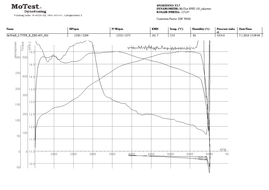

So I decided to start by getting a baseline dyno and the results are attached. 338 ehp and 553 NM.. This is apparently quite normal for worn supercharger and stock engine with those kilometers... SO now I only need to "double the power", not bad..
