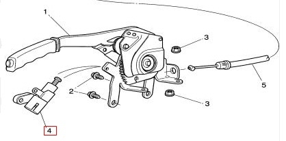

A dirty or faulty Handbrake Switch is the first thing to check. This is the manual lever version (item 4):
The Electric Park Brake has a control module and position switch.
Attached Thumbnails Handbrake Light comes on after a few minutes of driving...-s-type-handbrake.jpg

hi, thanks for the help. I can't find a part number for the switch, do you happen to know it? thanks.
