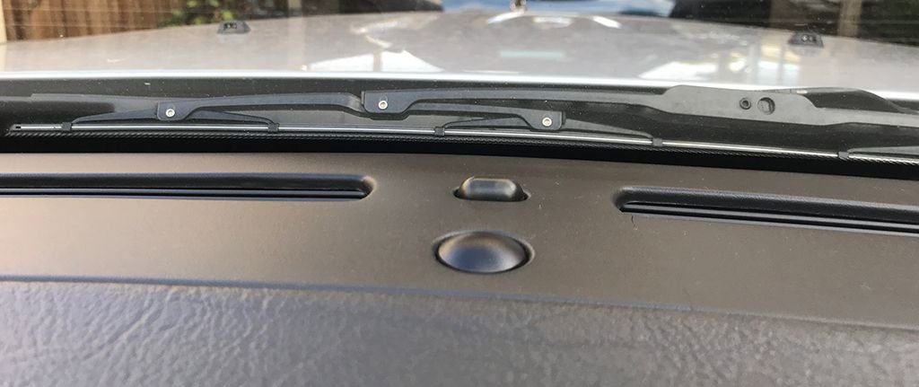

I think my headlight sensor-thingy is busted. If I switch the lights to 'auto' the lights will come on regardless of the ambient light level. Is this any easy fix? Obviously I won't bother if it means pulling the dash to pieces, but if it's something simple (can always hope!), I'll give it a go.

The solar sensor is a part of the PATS indicator bubble in the center of the demister panel on the dash on the 2002.5 and later cars; I am not sure about the arrangement on the earlier cars. A word of warning if your sensor is mounted in the demister/defroster panel and you have the later style setup - the demister panel is no longer produced and as they age the plastic part becomes quite brittle. If you crack/break the panel in attempting to replace the sensor, replacements from breakers go for crazy money on eBay and from used parts specialist firms as well...

Thanks for that. I'm guessing the round dome closest is the sensor? If getting to it means dismantling the dash, then I'll just ignore the issue and go 'old school' and use the switch. I thought it might pop out from the top, but I guess that would be too easy :-(

Actually, I believe it is the lozenge shaped unit closer to the windscreen.
The demister panel is a separate piece; removal/replacement requires removal of the A-pillar trim on both sides. The demister panel is held in place with spring clips, but extreme caution must be exercised to avoid breakage of the panel...
Here is a link to the part:
http://www.fordonlyparts.com/2000-20...w4t-14a597-ab/

On my X202 S Type R only one sensor is present, the lozenge shape plastic bubble piece which sits north-south not east-west unlike Ian's photo of his earlier X200.
I assume that the sensor that sits under this piece is the culprit that needs replacing, and that the A pillar caps need to be removed to prop up the trim to access this sensor.
And it sounds like that this trim piece therefore (that sits in front of the main moulded dash) is plastic and not steel thus creating all the issues...
That's crazy then, what's the point in trying to change the sensor if the bloody thing is going to crack? Very obvious place too, would not look very nice with a crack in front of the dash..

heh heh. It seems I don't have to stress about breaking the dash panel. I just noticed a small crack coming from the driver's vent ;-) You might be able to just see it in the pic above. Looks like someone has been here before. Not to worry, I've got a sensor coming, so I'm less afraid of doing damage now. I've had the A pillars off already for my DAB radio antenna, so I'm not scared of those either ;-)
