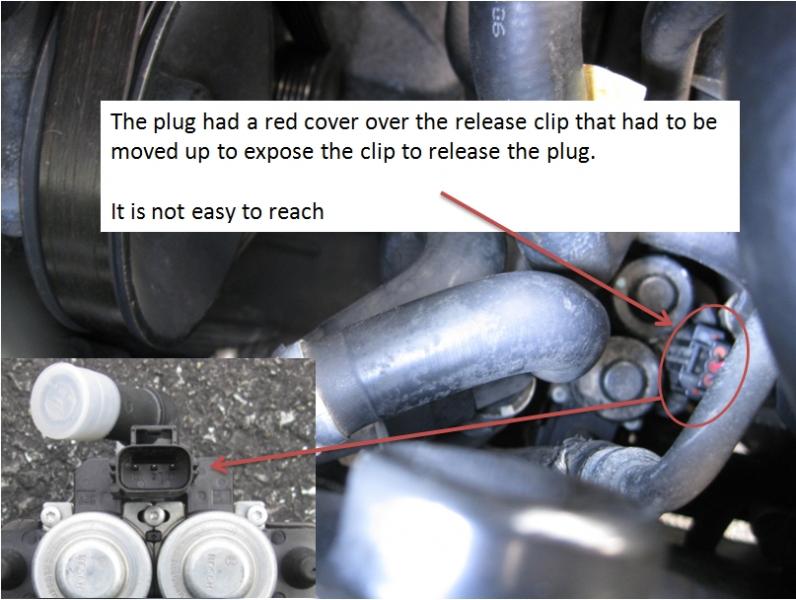

I recently had the same problem and will be doing my write-up on what I found, but for now see if you can remove the plug on the DCCV and see if you get heat.

The plug is a little strange. It is forward of the DCCV, on mine I had to slide the protective cover on the plug up to expose the latch to release the plug. Press the latch and the plug will come off.
I will try to get all the info up on my page. It is hard to do when I have been going up and down the road trying to get with the builder on my house.
