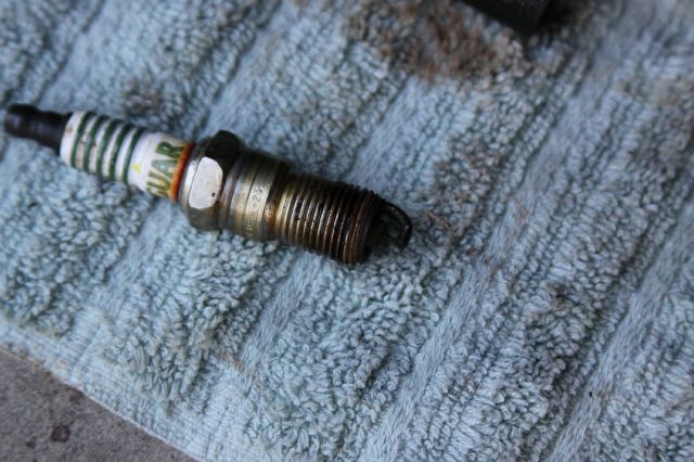

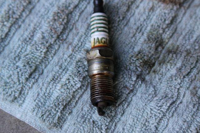

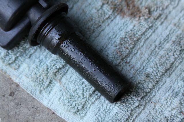

Default oil around coils?
Just pulled the first plug and coil and they are original. My question is what is the stuff around the coil, looks like oil and the plug looks fairly worn and also had oil around the threads which I guess is that material mentioned in the other posts to put on the threads, correct? ThanksHelp with plugs and coils 2000 V6-plug-1.jpg

Default oil in plug area, need some help soon
Hi, changing the plugs and I am on the drivers side of car. The slot of the plug closest to the inside of car had a little more oil in it then the front two plug slots and my concern was after I pulled the plug out it had oil on the threads. The place to refill the oil looks like where I pour it some would go in that direction of all the plugs but if some oil did get into the plug hole after I took it out, could this be an issue for firing? I can take some pics of plug with oil if need to be seen. Thanks for any help.

You are probably OK with a bit of oil getting in. I'm pretty sure that your generation car has what is called the IMT valve. It is an intake tuning valve and is attached to the back of the intake manifold. Since you have that off, replace the o-ring seals on the valves. They are known to leak and are probably what is causing oil to sit in the plug recesses. For a really good write up on changing them look for a thread started by JoycesJag referring to IMT replacement.
