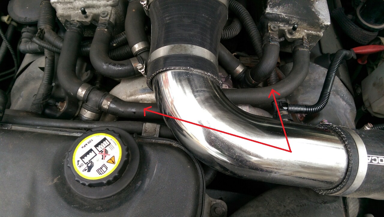

Today I was driving my STR and noticed when I had parked up that coolant was leaking out of the car and smoke coming from the engine bay. I opened up the bonnet and found that the hose which connects to the right charge cooler and goes underneath the intake pipe towards the coolant tank had cracked and was shooting coolant everywhere. I then got a Engine Coolant Low warning message although the temp gauge was fine.
I have attached a labelled picture of the hose I'm referring to. Would anyone know a part number for this hose?
Thanks.

No, but the parts thing (JEPC) is a free download plus there are a ton of online sites you can find the hose on.

Thanks! Unfortunately I couldn't get JEPC to work on my computer but I found the part required using the SNG Barratt Parts Catalogue. It is XR837410 Intercooler Inlet Hose I believe.

The hose identified by arrows in your photo appears to be the inlet hose for coolant, which has a part number that is VIN-specific.
Depending on the VIN of your vehicle, the part number can be XR837410 or XR852860.
+1 on downloading and installing JEPC so you can find part numbers.

I did check my VIN to be certain and I did require the XR837410 on my 2004 STR. Unfortunately you can not buy the individual hose I pointed out though so I had to buy the other two connected hoses which should make fitting a bit trickier as one is clearly connected to the other chargecooler but the other side leads off towards the intercooler pump. Thanks for the help.

The hoses come pre-assembled, so you must drain the cooling system to replace the inlet hose.
You may want to also consider changing the coolant return hose as well, which carries a part number of XR841497. Often when one hose ruptures, the others are not far behind.

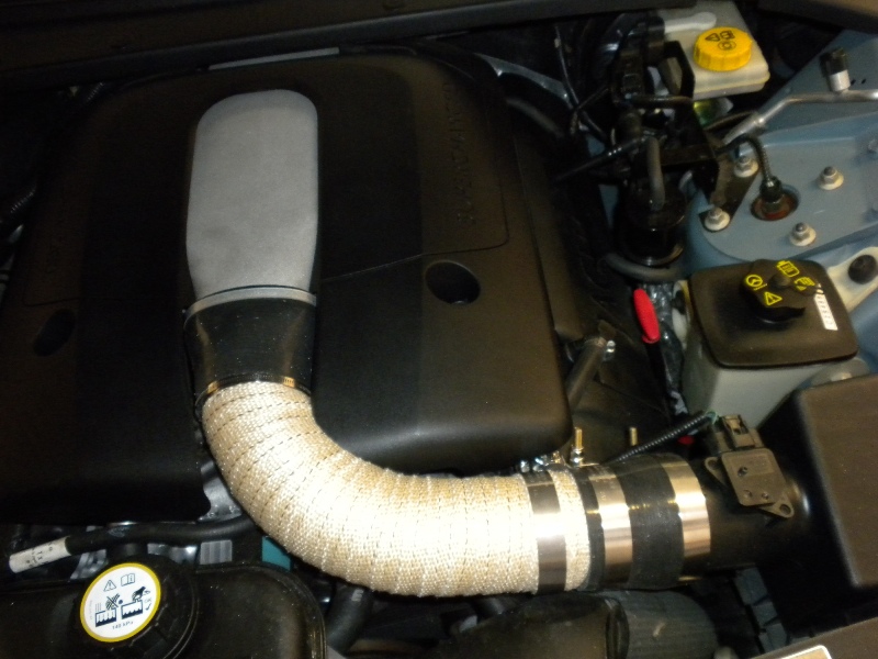

Originally Posted by JagSTR2004
...When the new hose goes on I will ensure that it is not directly being pressed by my hot stainless steel intake pipe
Here's what I did - some said "great", some said "not great", but all agreed that the insulation would help reduce the IAT, and maybe give a small increase in power. Also protect your hose from the hot metal.
