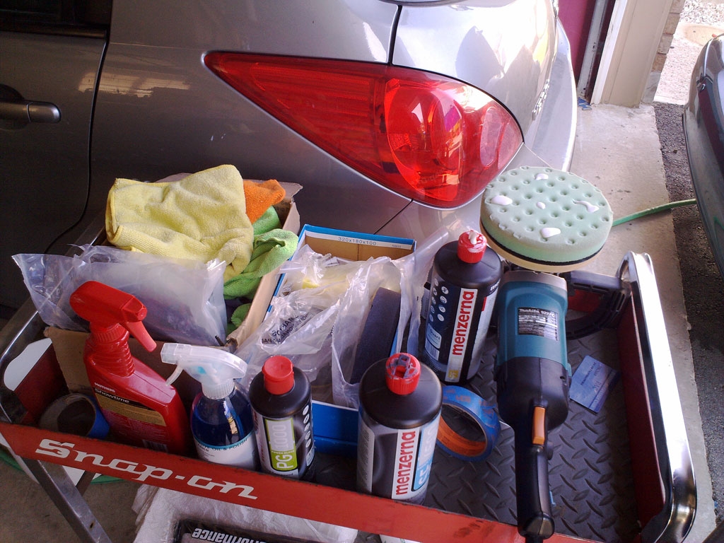

some pics of my setup when i first detailed jag, the aspen green mica is a very rare color on the STR, and it looks amazing as it is color-shifting metallic, did a major paint correction and car looks stunning!
Attached Thumbnails HELP!! Swirls on black paint!!-wg1346965904w5049119045787.jpg   HELP!! Swirls on black paint!!-wt1346965905w5049119102547.jpg   HELP!! Swirls on black paint!!-wu1346965904w50491190bc9c0.jpg
