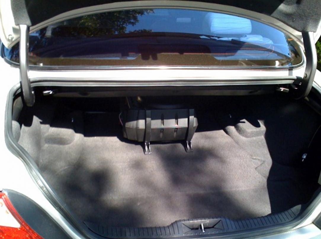

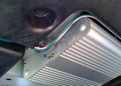

almost forgot about this post, i took some quick photos with my iphone that might help you with the install.
Attached Thumbnails Infinity Basslink II-1.jpg   Infinity Basslink II-2.jpg   Infinity Basslink II-3.jpg   Infinity Basslink II-4.jpg   Infinity Basslink II-5.jpg
