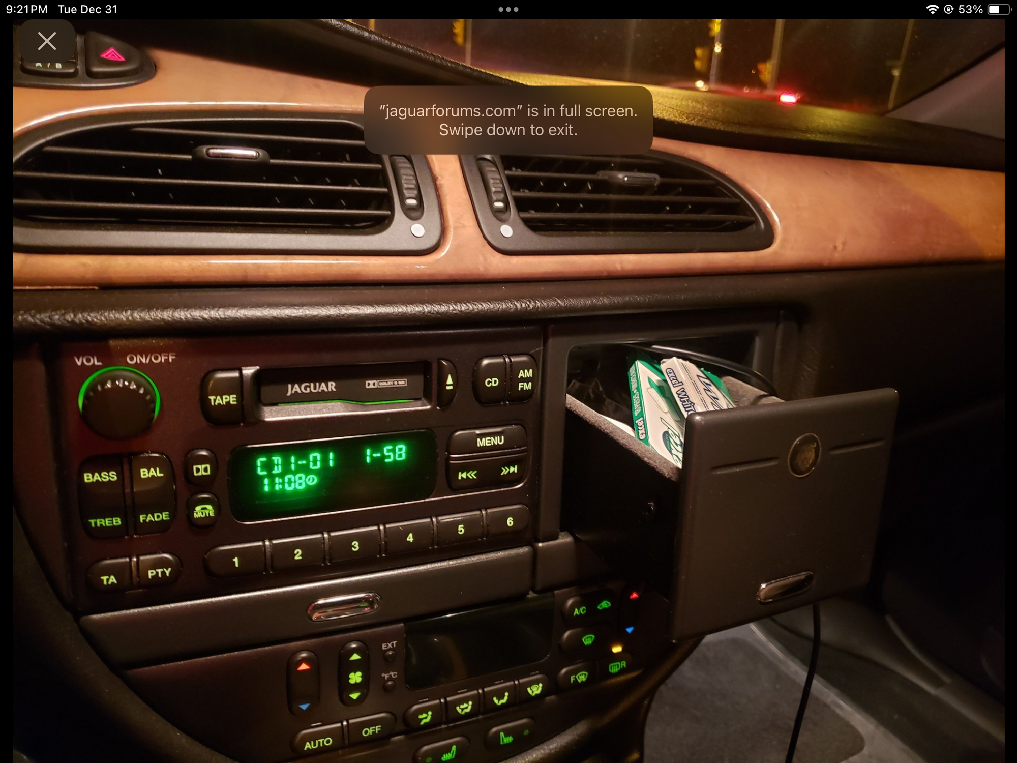

I use this in my 02 v8 https://www.ebay.ca/itm/196873837934...Bk9SR8asz_mDZQ
it’s a pioneer avid d3 with an rca to 3.5mm plugged in so the drawer can be closed and no cords visible. Pretty clean install & cd player still works. I mostly run Spotify from the aux cord. It was installed in march 2007 and the car and stereo still going strong quarter million miles later.
