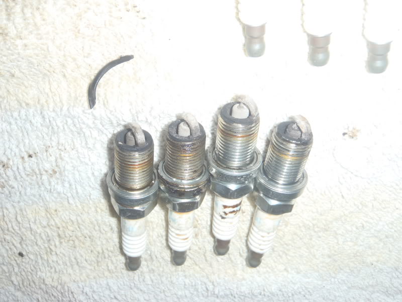

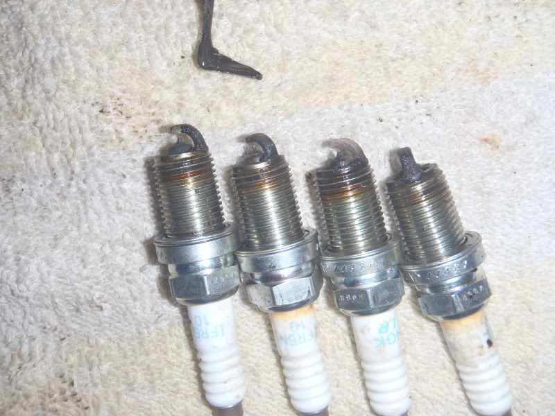

After removing parts I noticed the AF was crushed and not sealing and long over due for a change, deposits on the spark plugs, and 10000 miles since the last oil change when they used 20w-50. Vacuum tube to PCV full of oil.

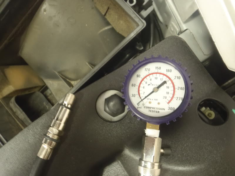

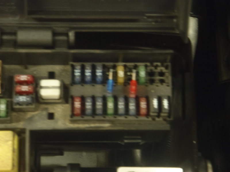

I decided to do a compression check while the plugs were out. I pulled the ign and Fuel inj fuses from the engine compartment fuse box.
The compression numbers from the driver side bank 180,180,190,170 and right bank 190,185,190,180.

I have attached the shop manual procedure and results. It looks like your OK. They don't mention any number except the lowest cylinder should be within 75% of the highest cylinder.
They also mention what I was going too about trying the test after a squirt of oil in the cylinder.
