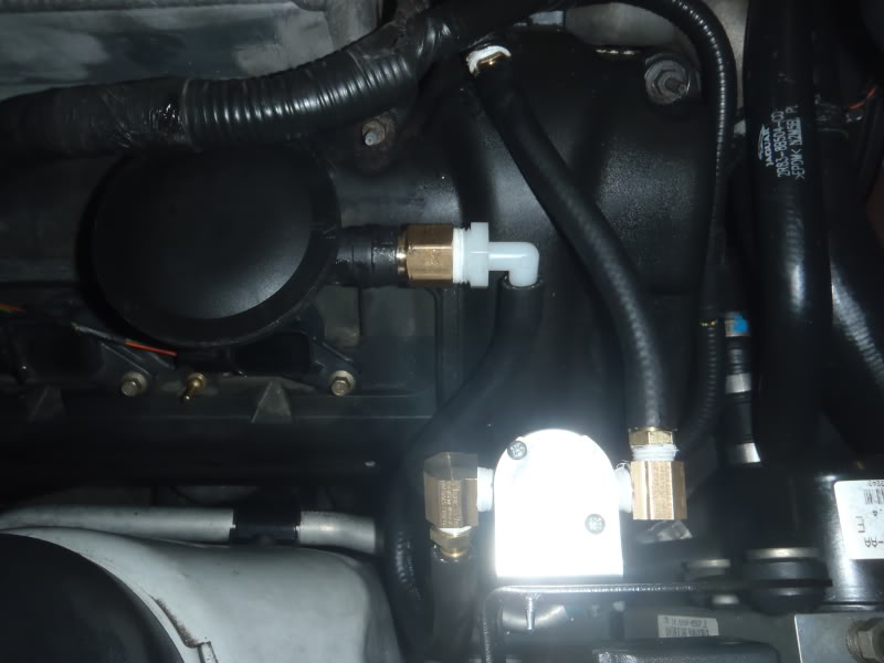

I installed a oil separator. Unfortunately my plan didn't go as planed. The oil caused the vacuum line that goes to the PCV to degrade and it broke off. On the bright side I eliminated a previous vacuum leak on the vacuum line to PCV connection but I think I caused a very small leak some where down the vacuum line. I ordered a new one from the dealer. I will change the set up a bit once I get the new vacuum line, maybe a hard line set up with some flare fittings.
The only down side to the oil sep is the small diameter airway compared to the stock set up. I can also hear a pulsating air flow noise from the PCV. I'm assuming the pcv will now not be able to handle the excess pressure from the crank case as well as before, can any one confirm that the excess pressure will end up coming out of the left side valve cover and vent in to the intake duct?

yes the oil separator works great. It would be better to have metal line flair fittings due to the amount of vacuum tends to collapse the hose a bit. I believe this design is much better over stock, I think the stock connection between the pcv and vacuum line does not completely seal, you mite be able to hear a very small vacuum leak with the correct tools. After I created my own connection that very small vacuum leak is gone.
After about 300 miles the separator collected about a T spoon of oil.
