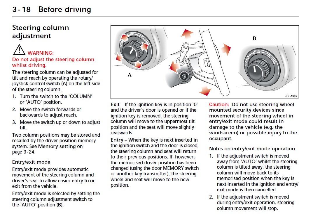

Your steering sounds to be set to Entry/Exit mode:
Attachment 49833
As you can see, this function can be switched off if you don't want to use it.
Attachment 49833
