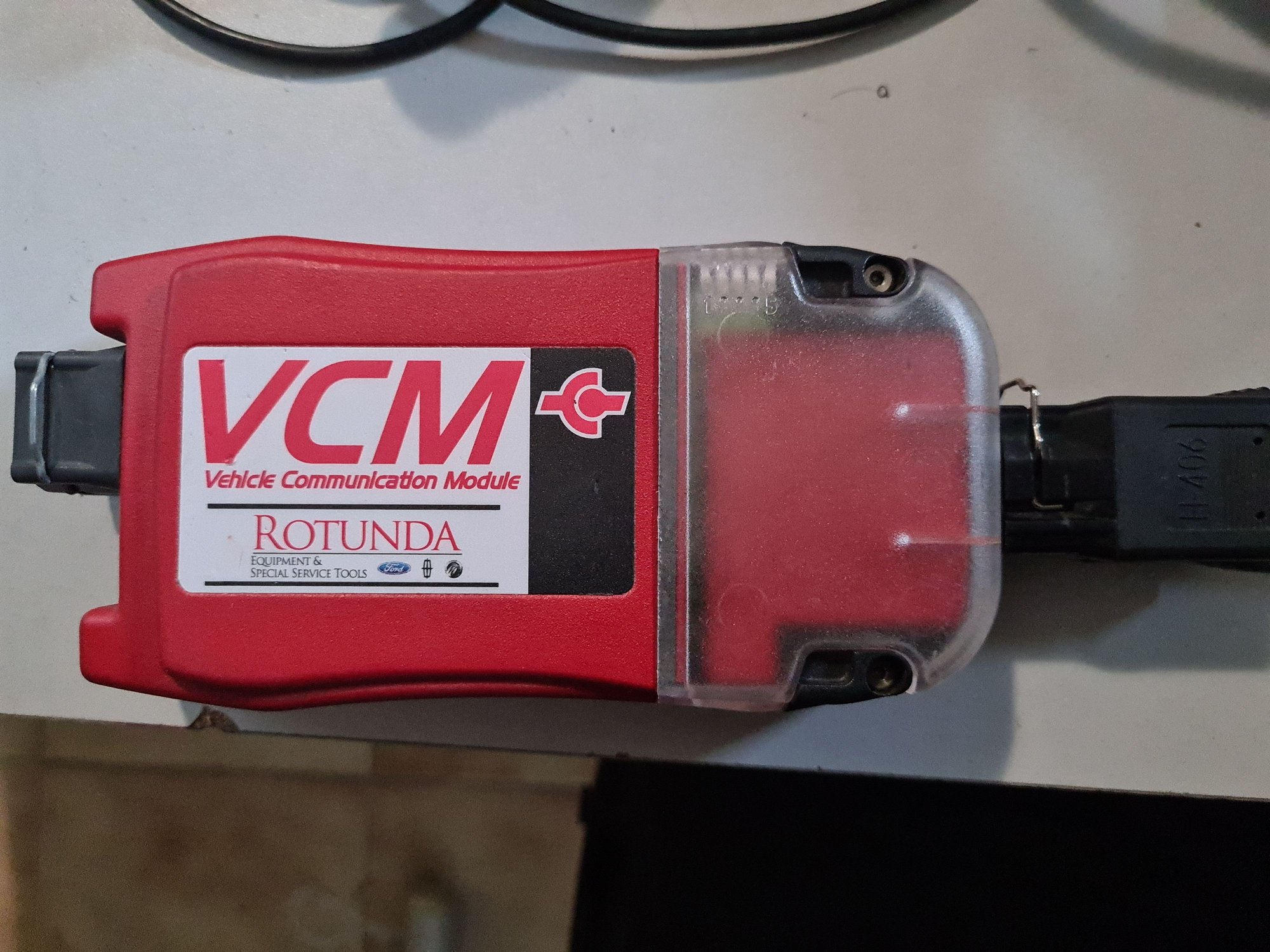

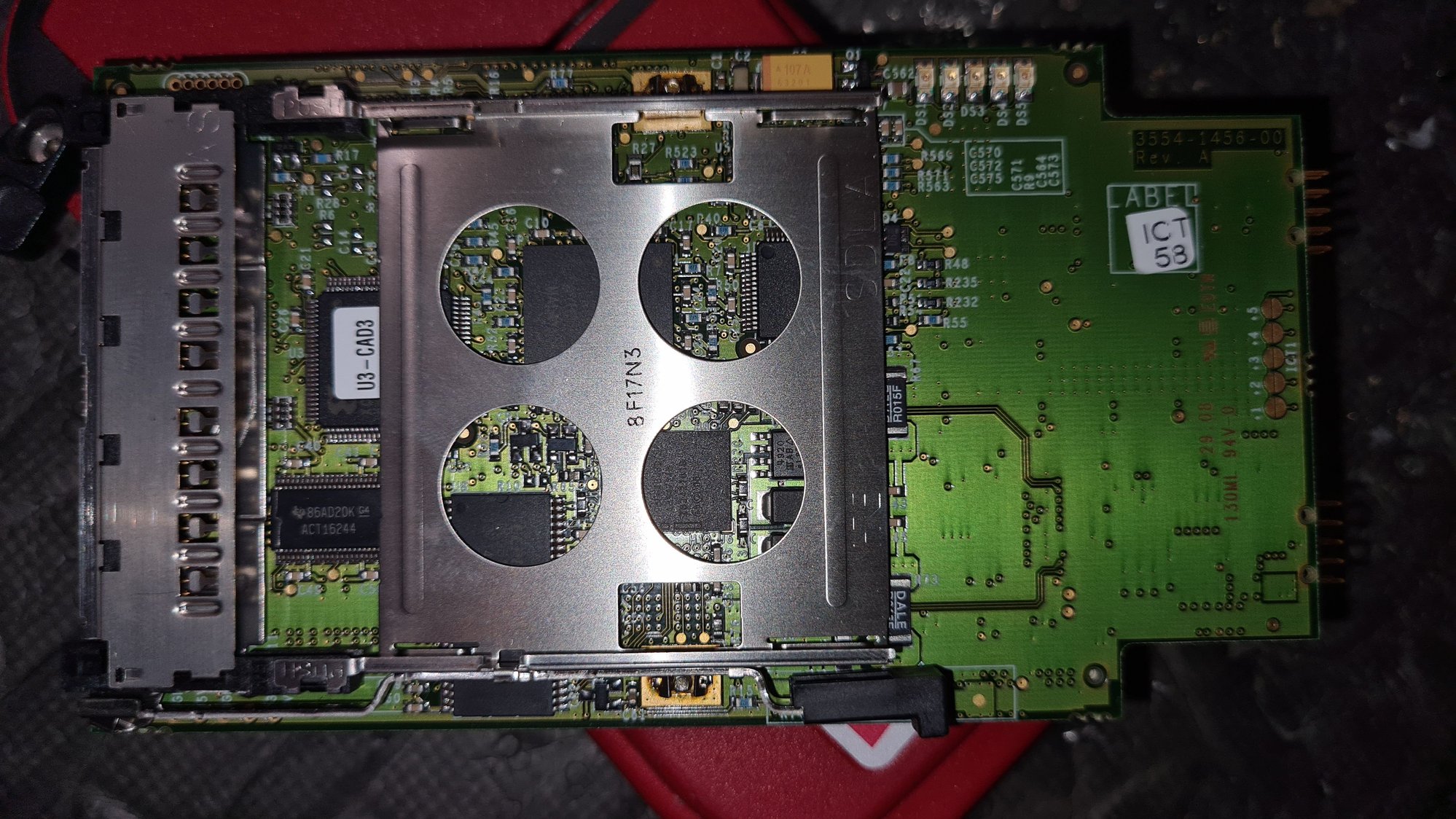

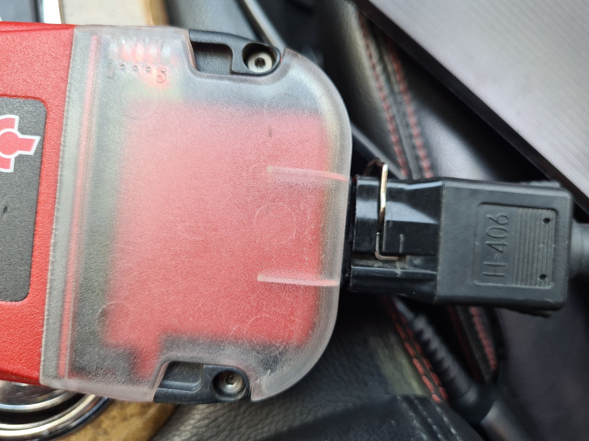

I have this cable.
Vcm genuine
Vcm pcb genuine
Clone cable (identical??? I think no)

you might be the first person i have heard of who needed to re-flash the CCM.
i am certain the clone cables are not good . and can cause cold sweats and vomiting .
btw Cambo has a thread some were about the differences of the units and cables .
the genuine Rotunda VCM/1 unit has gold solders and the clone has silver or lead internally .
yours looks legit . though cables im not sure of the differences .
but i'm sure you need the correct cable . about $300nzd if you can find one .
Cambo also had a link to some new ones a wile back . MIGHT BE WORTH A TRY .
BTW my TCM was reprogrammed with an Autologic PRO scan tool a couple of years ago, when i had to replace the TCM .
so the VCM can be worked around on some modules .
