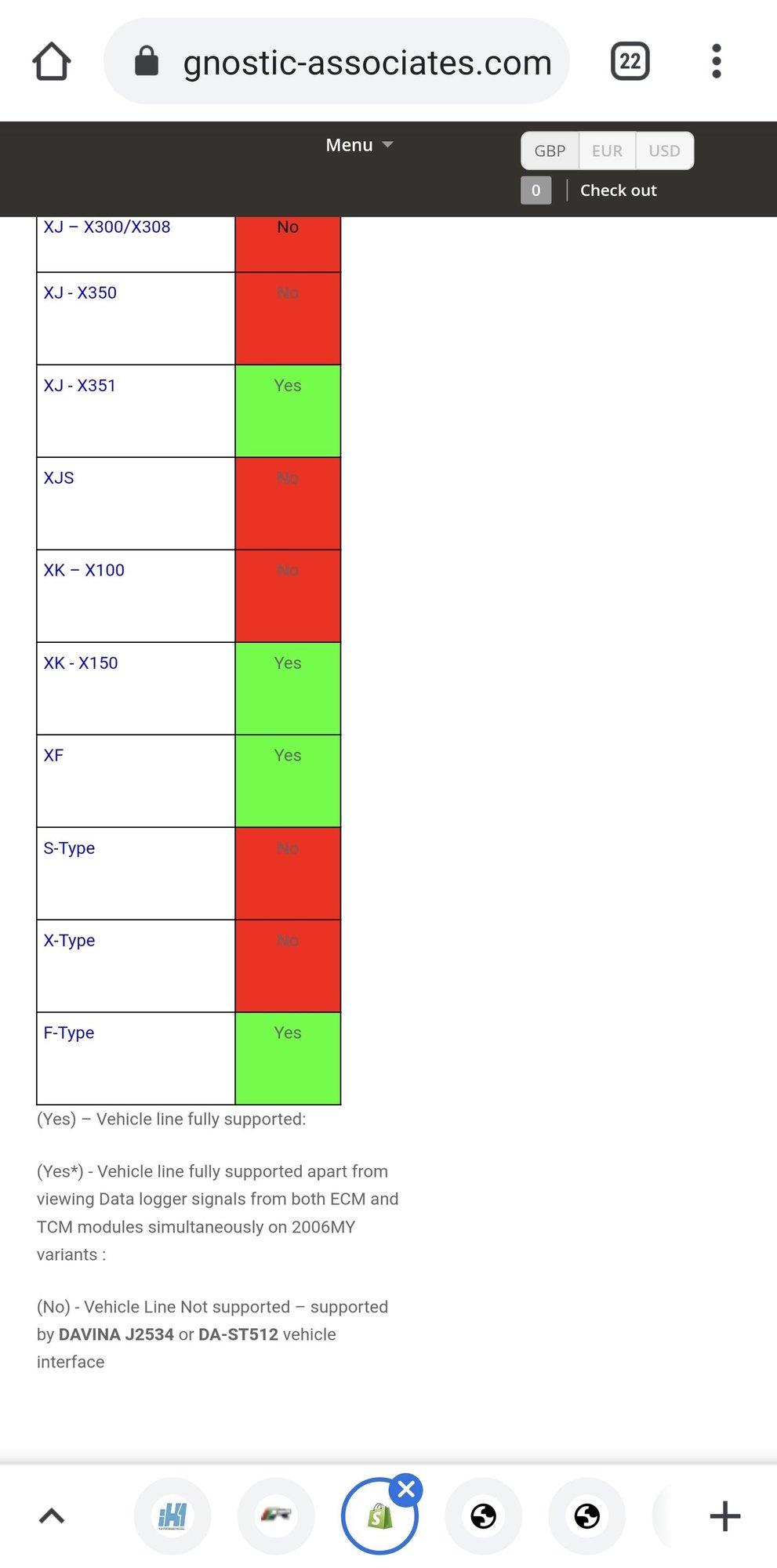

Originally Posted by xalty
https://www.diagnostic-associates.co...thru-interface
you can buy a new cable for your vcm for about the same price
Ahemmm see image... stype support : NO

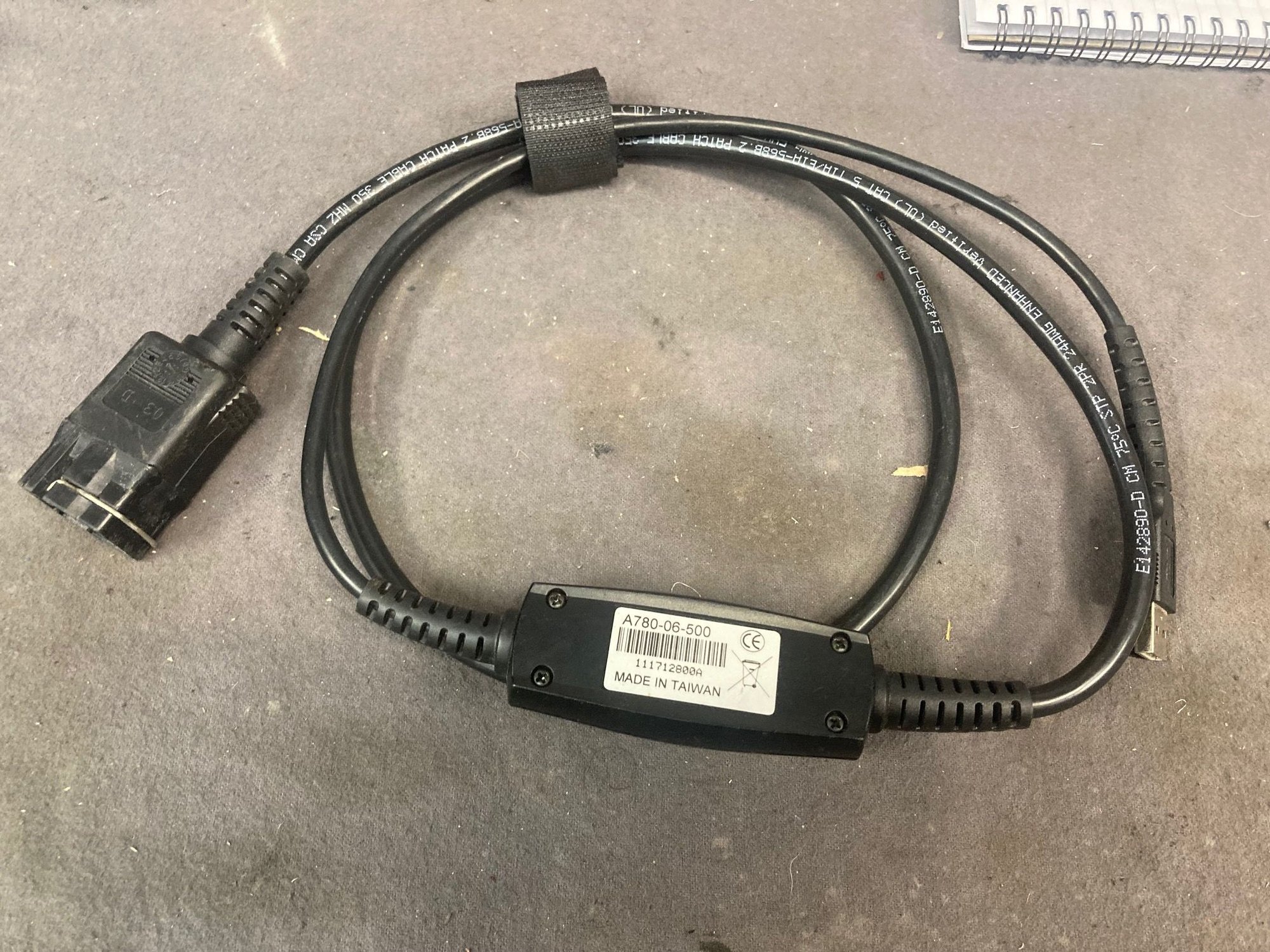

Originally Posted by ^SiRtA^
I hope i can buy a cable for my genuine VCM
I have one spare original USB cable. Just tested it with an original VCM and SDD. It works fine.

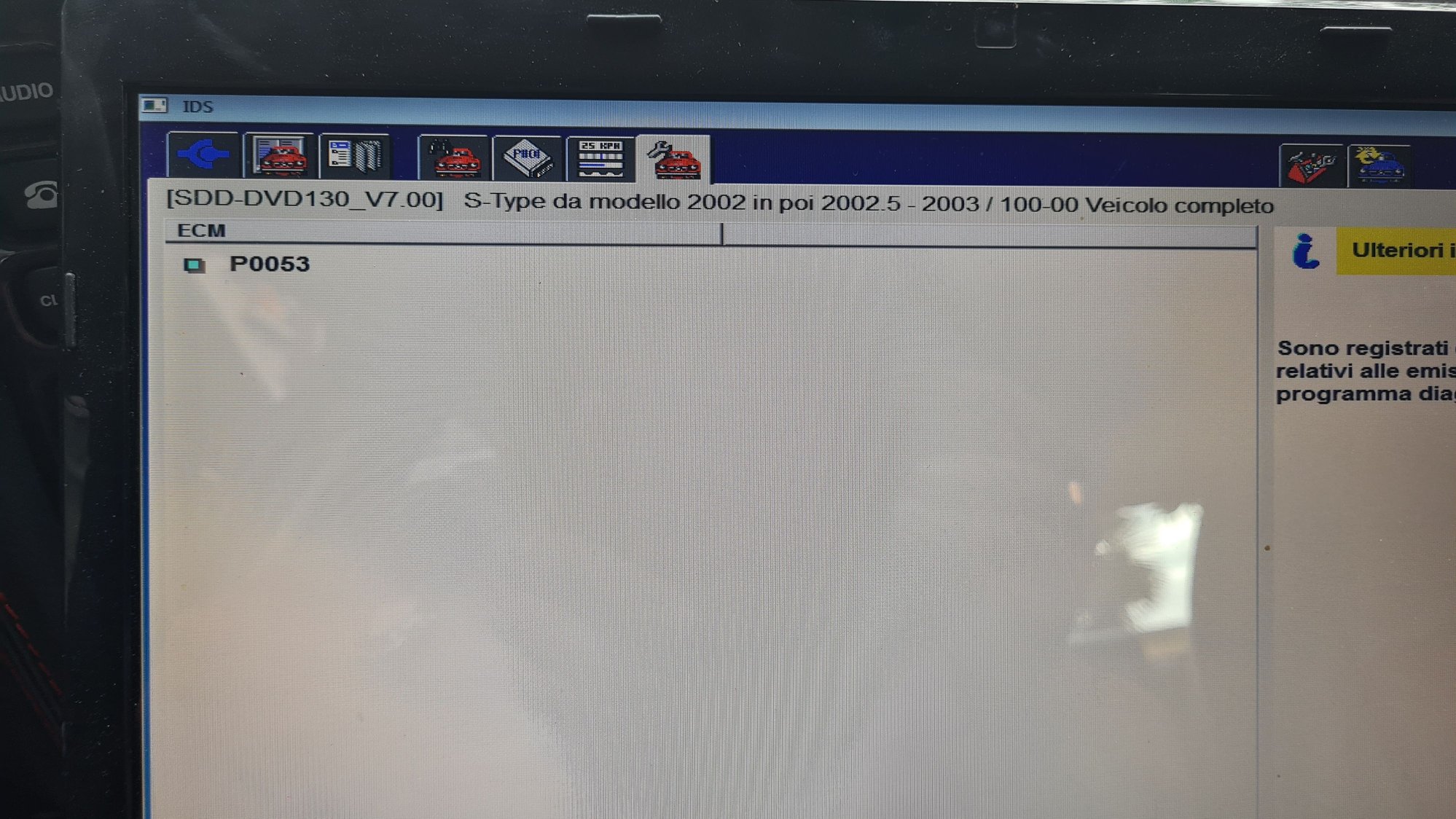

Ok bro, i tryed to reflash ecm from existing modules... see image !
If i go in the configure existant module, ecm, this is an error i see and i can't reprogram ecm..
