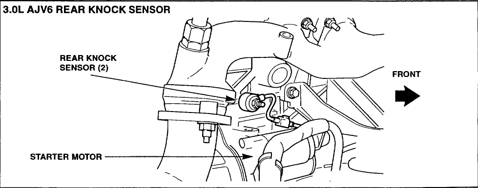

Does somebody know where to find the connector or the sensor to this V6 engine. I can purchase a sensor on ebay, but the JTIS workshop manual is not very clear on the V6 is olny showing V8 pictures.

I think one is next to the starter, I will check.
This is on a 2000 3.0 S-Type
Yes one is under the intake and fuel supply manifold and the other it suggested that you remove the starter to get to it.
Attached Thumbnails Knock Sensor-frontknocksensor2000-3-0.jpg   Knock Sensor-rearknocksensor2000-3-0.jpg

Thanks for moving the post and the answer. I will check the location of the sensor above the starter. Hopefully it is still the same my engine is modified series 2. Sensor 2 looks like easy to reach.
Somebody on the Dutch forum told me that there is only one sensor present (sensor 1 in the middle of two banks) that can calculated the knocking for two banks.
