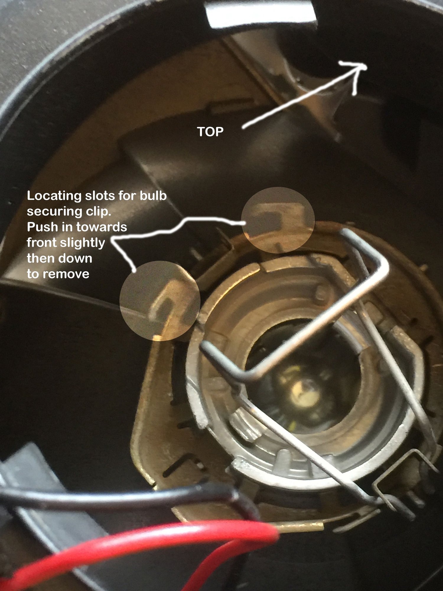

The bulbs have a removable adaptor which fits in place of the base of the halogen bulb, this is the fiddly bit getting the existing clip to hold it in. Once those are in the LED is put in and turned through 90 degrees to lock. As the actual light source ends up in exactly the same place as the halogen light source, the beam pattern is not affected. I then connected to the existing connectors, fitted the rubber caps and off we went. Due to the hefty heat sinks I monitored carefully that nothing was overheating, the longest being a 2 hour drive in the dark after which there was no sign of excessive heat. A word of warning, stick a towel or something below the bulb socket which will prevent mishandling of the LED adaptor being dropped inside the reflector. (Don't ask how I know this but if it happens you have to remove the bumper, remove the headlight so you can shake it out!).
Getting the adaptors in and clipped in place is the difficult bit,the nearside was fairly easy to fit, as were both main beams, but the offside dip was a b*&$£ due to the bonnet release cable. Putting the LEDs into the adaptor and turning is simple. In the pic below, the white adaptor is shown alongside the halogen bulb.
See below for how the clip is removed (and replaced)
