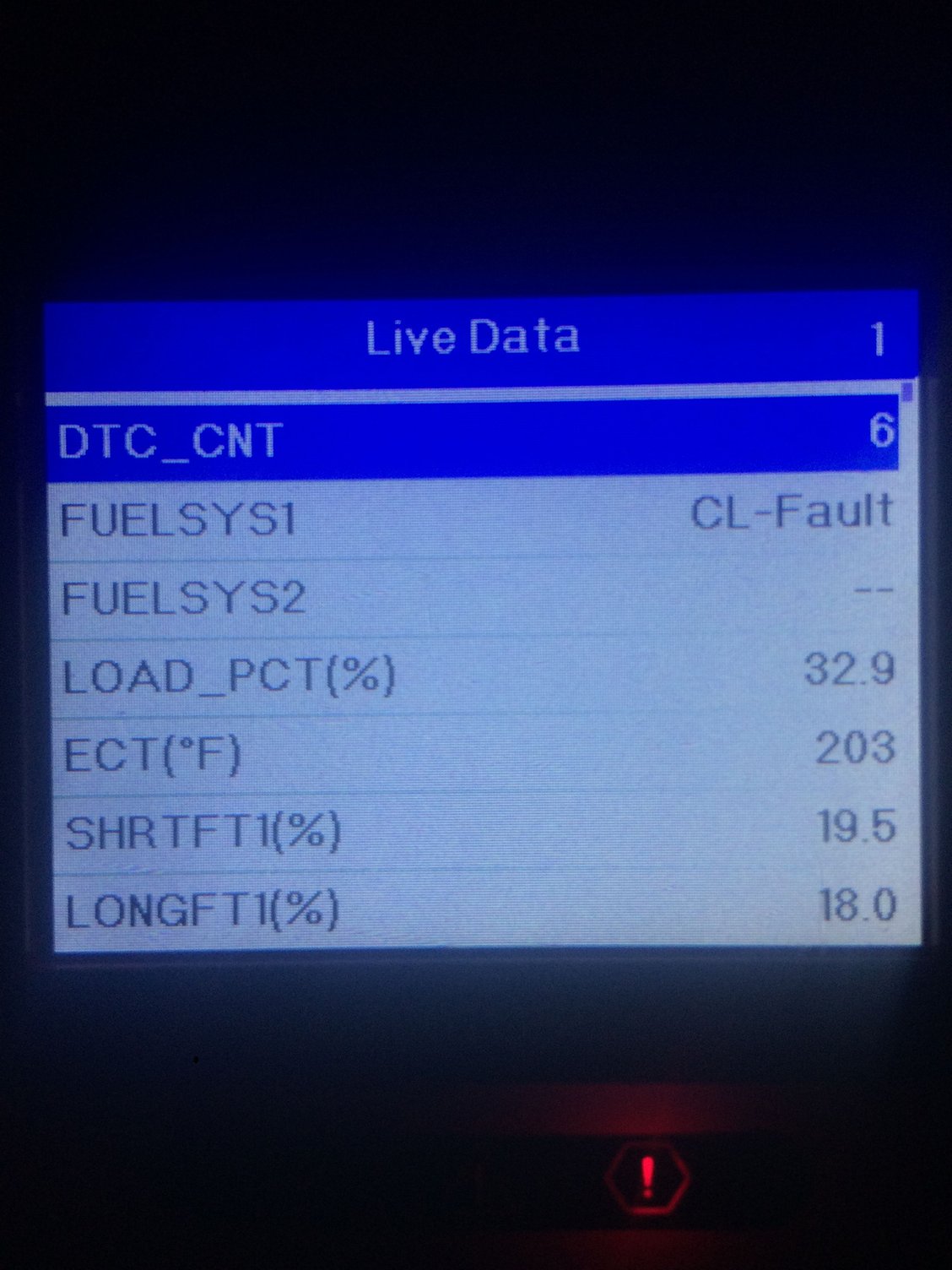

Alright Alright
Gentlemen , how’s That for my average running on idle temps in Fahrenheit ?
Old Jan 6, 2019 | 04:36 PM
  #28
JagV8's Avatar
Posts: 27,548
Likes: 4,925
From: Yorkshire, England
Something's weird. Fuel trims 0 (why?) and 6 DTCs. What are they???
OL-FAULT is also bad news.
Be afraid.
No idea why you're asking about temperature when the car's in the worst distress I've seen for months or years.
Can you not find a proper tech and fast before you write the car off?

Old Jan 6, 2019 | 04:51 PM
  #29
NBCat's Avatar
Posts: 6,068
Likes: 2,983
+` on misfire(s) and other DTCs.
IAT is for the inlet air temperature, not coolant or in the case of the 3.0 litre, cylinder head temperature (CHT).
Why are STFTs and LTFTs at 0.0?

Okay then , let me put it to you like this
the readings on the computer vary depending on idle and drive mode so the second and DIFFERENT set of pictures is what it showed me on drive
>>>>> OL FAULT vs CL FAULT
>>>>>SHRTFT&LNGFTzero vs SHRTFT&LNGFT18.5&19
And since I’m kinda grateful to this community for heads up with overheating issues that I had no clue about , I’m also keeping my cool replying to the ‘weird’ comments
Do you understand me now , ‘JagV8’ ?

Old Jan 7, 2019 | 09:24 AM
  #34
NBCat's Avatar
Posts: 6,068
Likes: 2,983
You need to find and fix the cause(s) of the Open Loop. The ECM is compensating by making the mixture extremely rich. If you don't find and correct the air leak(s) and misfire(s), catalyst damage is the result.
If the MIL is flashing, catalyst damage is occurring.
What DTCs are stored? Post them here so suggestions on corrective actions can be given.
As I said you're ignoring people e.g. posts #28 & 29.
Taking yet more pics just wastes more time.

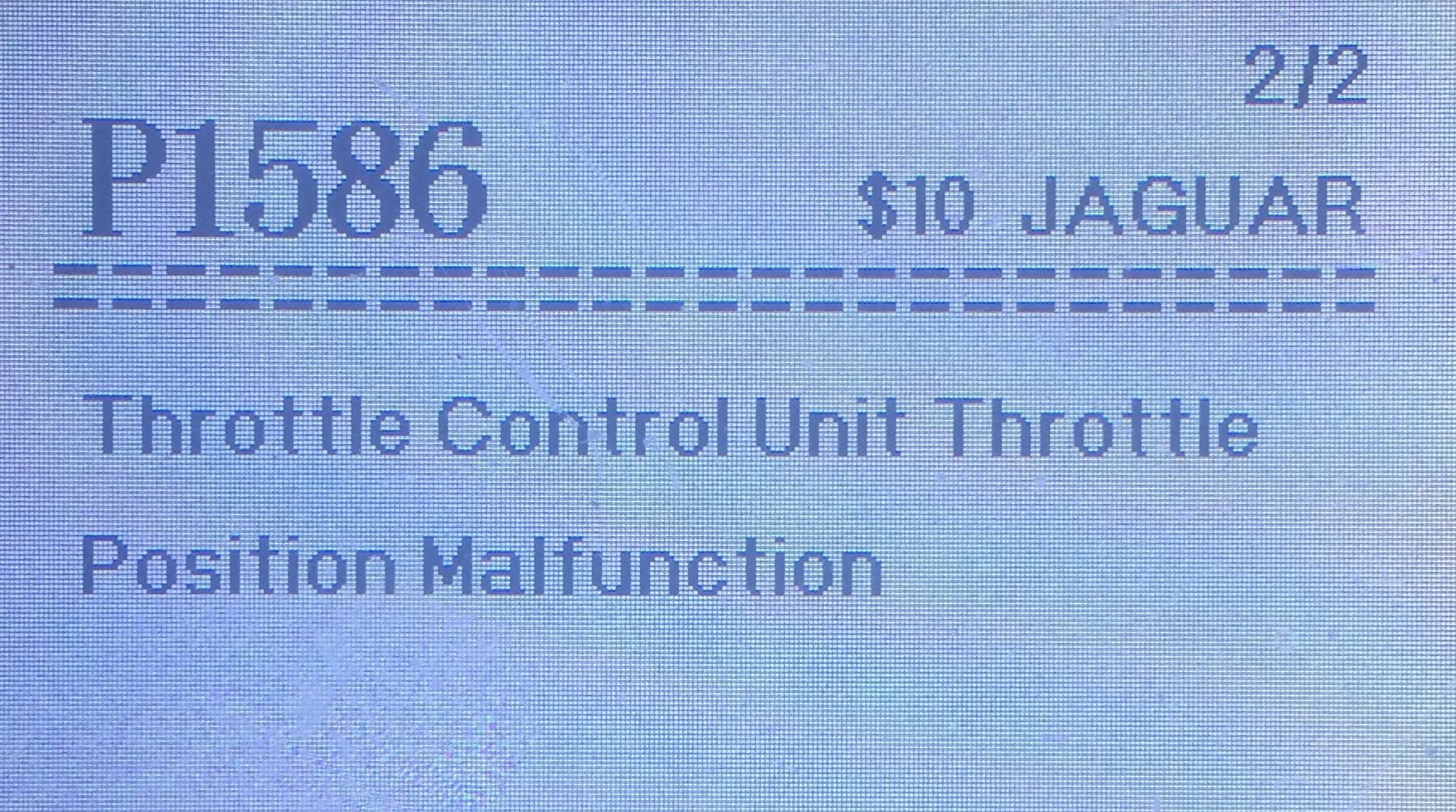

Read the codes and post them...looks like car is keeping system in open loop fuel control...codes will give us more pinpoint info...pics show you have definite problem, but now need the dtc codes

Pending
Last edited by JaguarJacks; Jan 7, 2019 at 10:17 PM. Reason: Erased the codes yesterday to refresh the system
Old Jan 7, 2019 | 10:18 PM
  #38
JaguarJacks's Avatar
Joined: Jul 2018
Posts: 63
That a few hours past erasing the codes to refresh
