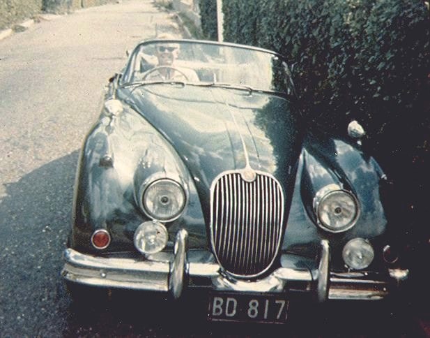

What is that model in your picture? It caused a short but intense fit of envy..

XK150 I believe.

That was my 1961 XK150S, had the original E-type engine. Loved that car but got married and had to cut costs, sold many, many, MANY years ago for $600, present value nearer to $100,000. Pic below.

Ouch! Best not to think of it's current value!

That car would look at home on any film set. Oh well l bought a gentex last night of ebay so here's hoping!!
