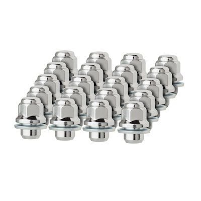

I had those sorry two part lugs when I got mine. Tire store idiots broke one off and stripped a second one before they had enough sense to come and get me. I replaced them with these for under $35. They have worked just fine. I put anti-seize on lugs and that has worked out well.

Still quite happy with the Mitsubishi MB579290 one-piece lug nuts I installed on my S-Type back in January 2010. I did an oil & filter change / tire rotation last Friday. There was no trace of rust on any of the lug nuts and the chrome remains completely intact. While originally a bit pricier than some of the other options out there, these have indeed remained pristine....
https://www.amazon.com/gp/product/B0...?ie=UTF8&psc=1
I replaced mine with Toyota/Lexus lugnuts 4 years ago. They look similar to the picture you posted.
