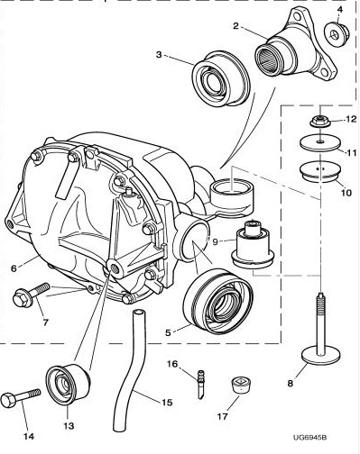

Thanks for that but I can't find any dust cover anywhere??
Here is the rear diff.
