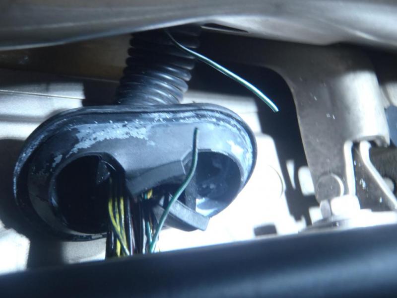

On my 2005 s type the driver door switch will lower but not raise the passenger window. I hooked this switch up to my STR and it worked normaly. So I guess I'm dealing with a bad module? Could a reprogram help? If I take a module off my 03 STR will it plug in and work in order to help diagnose?

Is there a common area for wiring issues, maybe the wire loom between the door and body of the car?
I swapped the DDM with one I know is good and had no change, assuming the ddm controls the master window switch.

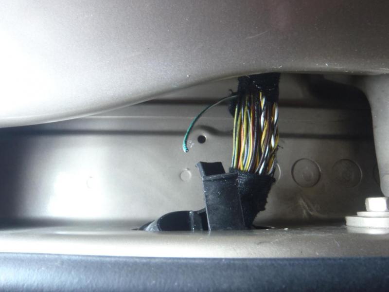

There have been 1 or 2 members over the years that had pinched wires between the door and the body.

The wire diagram shows the DDM has nothing to do with the window up/down switch wires, I'll start probing wires this weekend.

As this wire harness enters in to the body of the car I cant seem to find any access points to probe the GW wire. Any tips? It looks like the harness runs in between the layers of the unibody.

Found and fixed my broken wire on the driver door loom that runs in between the door and body.
