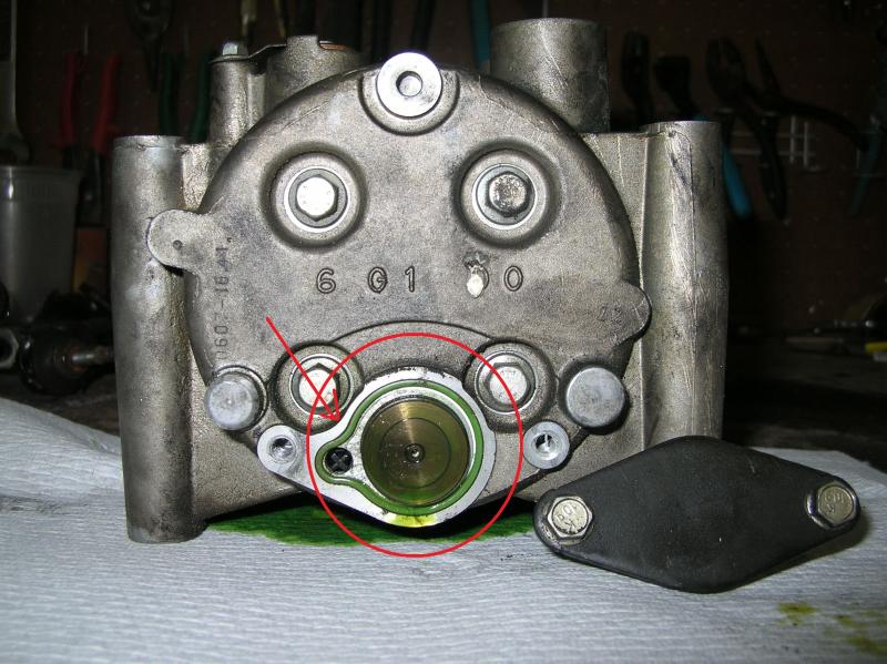

Mike pm'd me about his AC compressor not working correctly. I remember reading a post by a tech(?) not so long ago, about cleaning the screen and not having to replace the compressor, but my searching has come up empty.
There is a TSB about cleaning this filter (screen), anyone that can remember please post back to here. Picture is what needs to be cleaned.
Hope this helps Mike.
Thanks guys

Rick, nice of ya finding the pic of the a/c compressor. Looks like the screen comes from the area featured in the pic?

Yes Seth, the smaller black hole on the left in the red circle. It is a 2 part screen that needs to be cleaned. I have pics of that (the screen) but not downloaded to this puter yet.

PM Motorcarman. He brought that (TSB) up just the other day when we were discussing something else mostly unrelated. He just performed one recently, on an S-Type, despite some "a/c expert" assuring him it would make no difference....but yeah, it worked.
I'm getting old...memory not what it used to be...or maybe I wasn't listening closely enough...but something about reversing the filter and the valve.....maybe?.....
edit:
hehe...what I "meant" - reversing the spring and the valve.....thanks Brutal!
wait! Orifice tube AND a txv? (and OT at the comp!!?!) what kinda screwy system have we here? That's as bad as one of the high-end BMW's of a few years ago (7-Series?) that had electronic feedback actuators driving bowden cables to operate the flaps!

you need a orifice tube extractor to carefully remove it. or buy a new 1 not at jaguar but maybe ford. check with ac compressor rebuilders online. But I can tell you taht compressor in the pic is the old style that suffers from poor cooling at idle that many want to replace the compressor for which yes does fix the problem.BUT.....the big valve in the pic next to the orifice tube needs to be removed, the spring behind it taken out, the valve reinstalled, then the spring reinstalled behind it and the plate reinstalled. This fixes the poor cooling at idle. This only works on the compressor with the plate. the later ones do not have this plate or valve......

That explains why my new one doesn't have the plate and all the stuff behind it.
