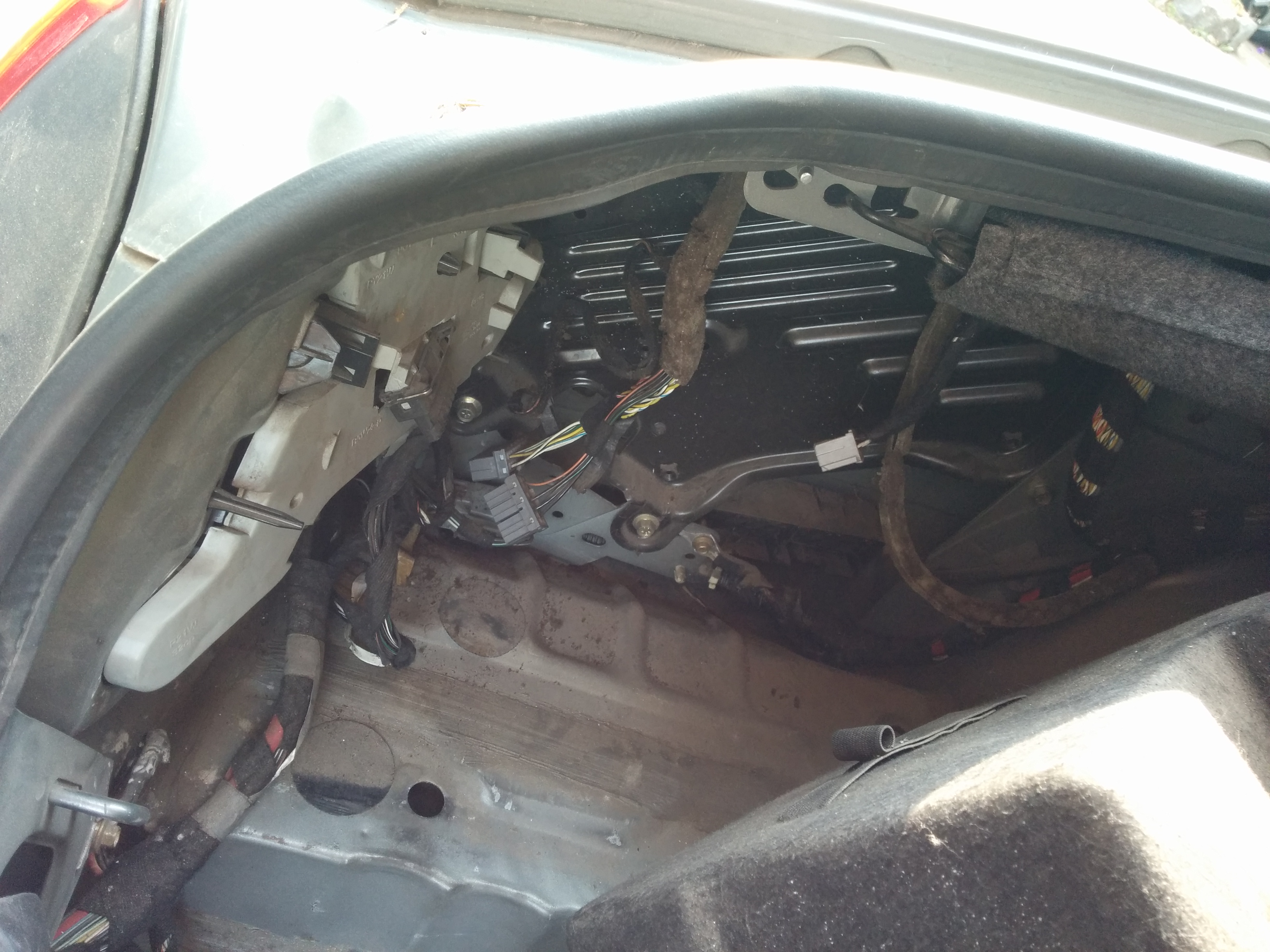

Hey there I seem to be missing a module from the driver's side trunk, I have absolutely no idea which module it is if anyone can help me out figuring out I would really appreciate it, already went through several documents and Google searches but no luck yet. Please see attached picture for reference

That is the location of the CD changer.

Unless someone paid a fortune you'll be missing lots of modules - quite normal.

Depending on model year, this could also house a DVD unit used for sat/nav. Sits on top of the missing CD changer.
Rather than making different wiring harnesses, Jaguars and Fords of this range of years will have prewiring for just about everything, even if the options are not installed.

Does everything in your car work?
As was posted above the cars are pre-wired for almost all options so it is plug and play on the assembly line.
