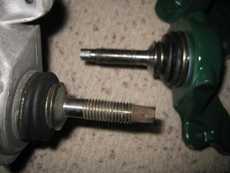

As far as I know there is no washer on the lower ball joint. Perhaps there might be one on a replacement ball joint that goes below the lock nut. (OEM ball joints have a washer built into the lock nut.)
Image of an original ball joint on left and rebuillt on the right.
