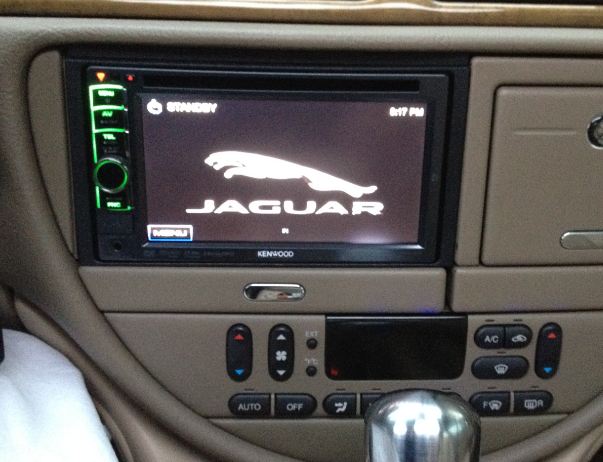

Thumbs up Finally got it done!!
I ended up returning the Sony and got a Kenwood instead. Well... no dash kit exists for the 2000 S-Type, so if you want to replace the stock one, you can have gaps, or do some custom work. I finally got mine to look good after hours and hours of trial and error. I ended up using a dash kit for a Kia or Hyundai, a bit of cutting, glueing, etc. and waaalllaaa! I've attached a picture.

Jason, looks nice!

was that a metra kit you used? and if so do u have the model # of the kit? that fit looks pretty decent. is it cage mounted or or ISO mounted?

WOW it looks awesome Jason, I have been trying to get on installed and I had the same problem. What do I need to do to get mines to look like yours? SWEET!!
So sorry for the delay in my response time! I haven’t been on this site for quite some time! To answer your question, it was a Metra, part #95-7321, purchased at AutoZone. Metra Part # 95-7321 | Hyundai Accent Dash kit | Metra Online I did a bit of cutting, gluing and fabricating to make this fit with the stock Jag stereo bracket, no cage. It took many hours to get it right, but it works! Be creative…… I hope that helps.
