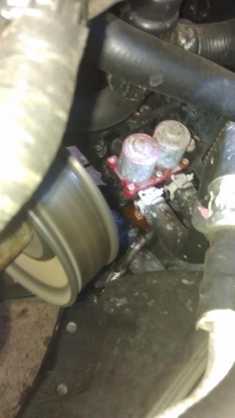

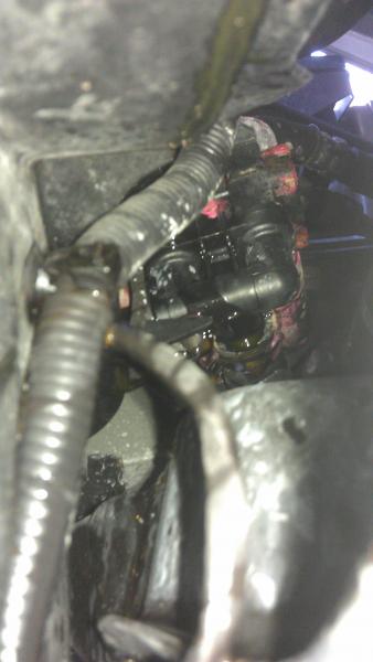

My wife has a 2003 S-Type 3.0L.. The problem is leaking coolant.. I was told it was coming from the electric pump to the heater core.. I took some photos (down underneath the resorvoir, top and bottom view) and I see coolant. Just wanted to confirm if this is the pump and 2ndly can it be repaired by a DIY or have to go to shop?
Thanks in advance of responses and look forward to being part of the forum.
Attached Thumbnails New guy out of Atlanta GA.. I come to forum with problems-jag-part-top.jpg   New guy out of Atlanta GA.. I come to forum with problems-jag-part-bottom.jpg

It's not the pump, the V6 doesn't have one.
The part in the picture is the DCCV dual coolant control valve.
If you go to the tech section and search for those terms you'll have plenty to read.
It's a fiddly but straightforward repair, you can get a Ford valve cheaper than the Jag part, but you will find all that info along with part numbers and pics in the tech section.

Welcome phat535. Ditto to all and do it quick cause a blown DCCV can toast the climate control module. If it did this already, when the a/c is on you'll have cold coming out of some vents, heat the others. RockAuto.com sells the DCCV (same as Lincoln LS) for $80.

Awesome! Thanks all for the replies. I will find the part and try my luck at installing. Keep you all posted.
