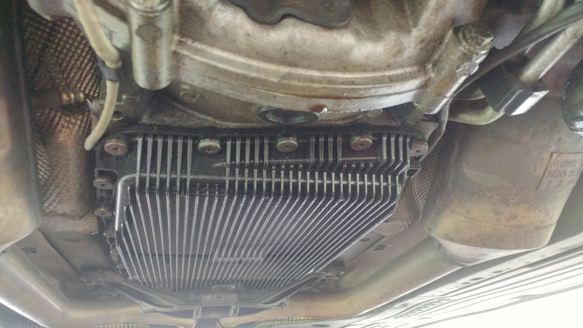

Okay I got it up on jack stands and got under it, it has the green front shocks, is that the active dampers? It also has the finned transmission pan, I assume that's normal?

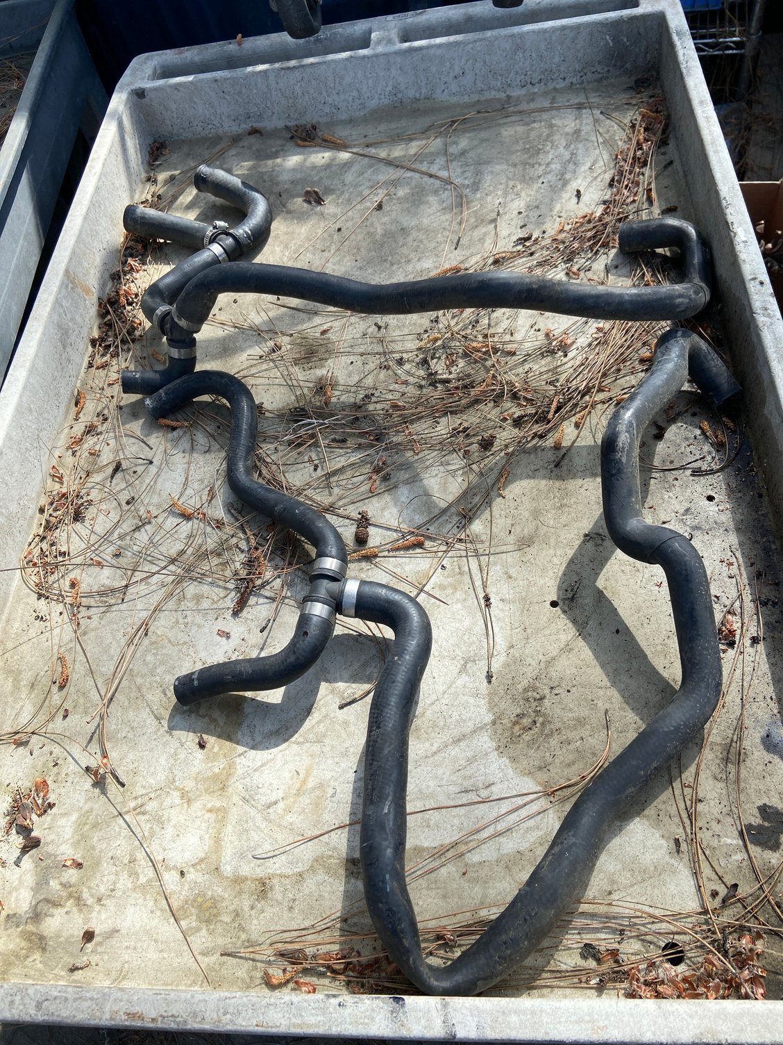

Okay I got under it and I have a small leak coming from what I presume is one of the intercooler hoses right where it comes off of the thermostat housing, the hose routes around the radiator and into the front of the car under the bumper so that's why I think it's an intercooler hose. Hose is a little squishy so I think it probably needs replacing, it just Heather standard hose clamp on it right now but looking online it looks like that should be a quick disconnect hose, is it possible somebody cut the quick disconnect fitting off the end of it? Should I buy the special intercooler hose online or just go to the auto parts store and get standard heater hose?
i would get both intercooler hoses that go to the coolers. I did the fix as they blew two times then just replaced both with oem
Old Apr 10, 2021 | 12:18 PM
scottjh9's Avatar
Joined: May 2018
Posts: 2,150
Likes: 760
From: california
These 2

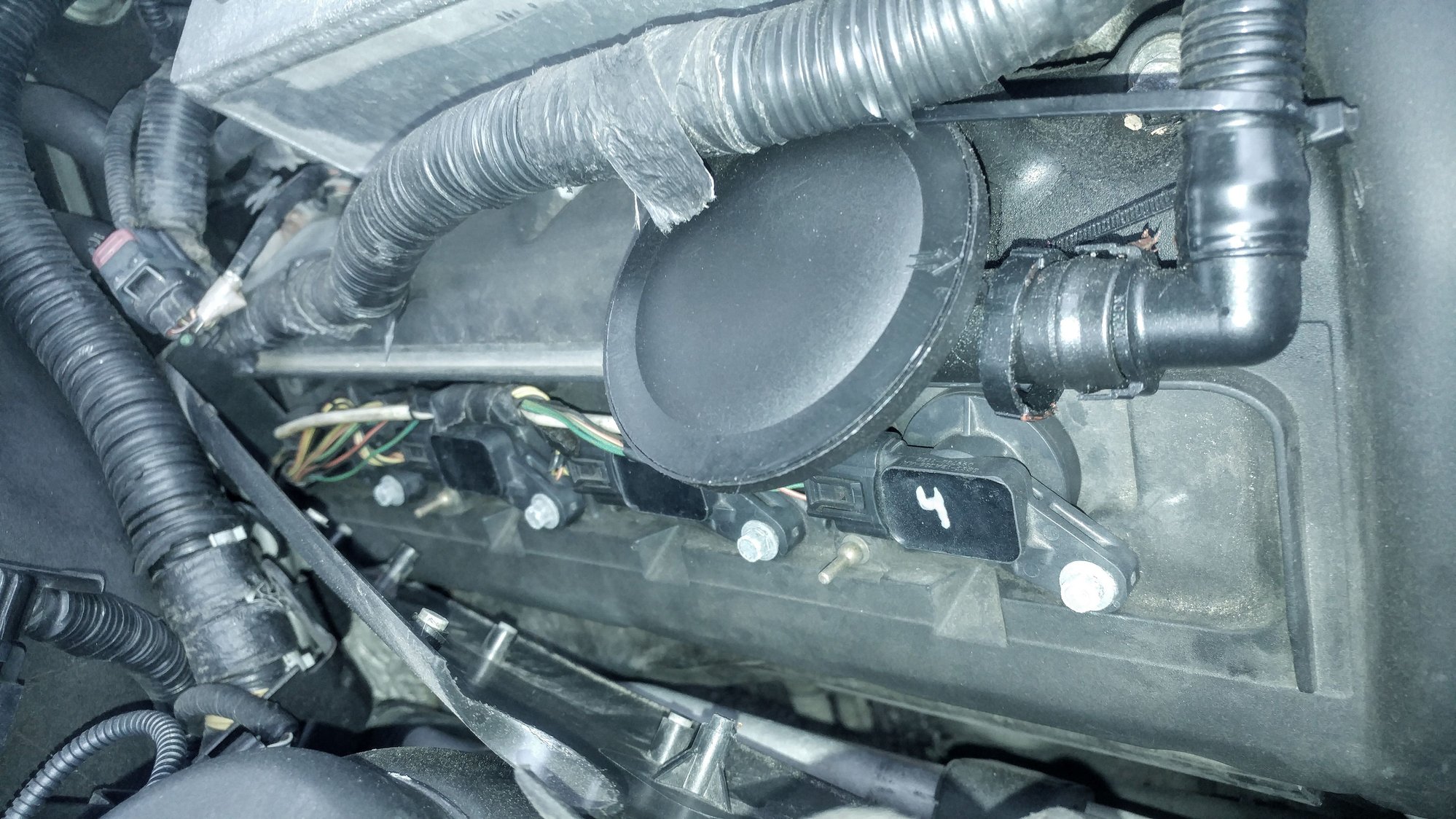

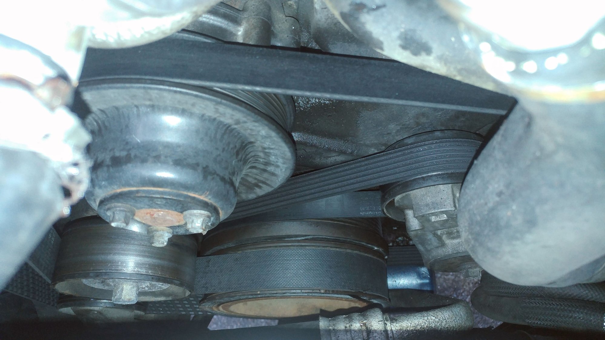

Thanks for the reply. I did take some pics today.
Looks like at least one coil was changed recently.
Little bit of moisture around water pump area - maybe a leak there, but hard to tell.
Small drip on the bellhousing but not a lot of oil.
Bottom front of engine is really wet, will clean it tomorrow and see what comes back, the leaking intercooler hose could have coated everything.
Did not take a photo of the shock tower but I would characterize it as weeping, not blown. Lots of years racing dirt bikes so very familiar with blown shock level of oil.
Did not see any green PAG oil, will check tomorrow to see if the compressor looks new. Strange thing, '03 Disco compressors are damn near bulletproof, wonder why the STR's gave problems..
There is a totaled STR close to me, currently trying to buy the touchscreen off of it, anything else I should buy?
No excessive silicone gasket maker poking out anywhere, valve covers not leaking, tiny bit of cream colored gasket material off one valve cover. I am at least hoping the valley hose was done. I find it strange zero service history up to 150k, car came out Charlotte NC area, was leased for years. No service other than inspections, I am guessing it went only to dealer. Going to call the dealer Monday.
No signs of worn suspension bits but will inspect closer tomorrow, but no unusual noises. Just a little floaty at speed but I am wondering if I am just expecting more BMW like stiff handling.
Old Apr 11, 2021 | 08:53 PM
jya's Avatar
jya
Joined: Aug 2008
Posts: 629
Likes: 175
From: Melbourne Australia
The 'lower front control arm-forward' large bushes are not possible to see if torn unless removed. Same I think with the 'Lower control arm-Lateral' bush. May be reason for float?
These are fairly well planted machines. It's an 1800 kg car so no Mazda Mx5 but they should handle very well. From X202 on the car had quite an extensive suspension update. The lower control arms (or 'A' arms) I mentioned were a new 2 piece forged aluminium design and also new upper A arms, again in forged aluminium. There was also a new stiffer squeeze cast aluminium upright as well ('Swan neck wheel knuckle'). So a classy, premium well engineered set up and most of these new components shared with the newer XK and XJR's.
Tiny bit of cream coloured material is normal if close to where the cam cover meets the timing case cover. Perfect that there's no cam cover leaks - at that mileage, must have been done. Perfect there's no full silicone either. You could be very lucky and valley hose may have been done also.
