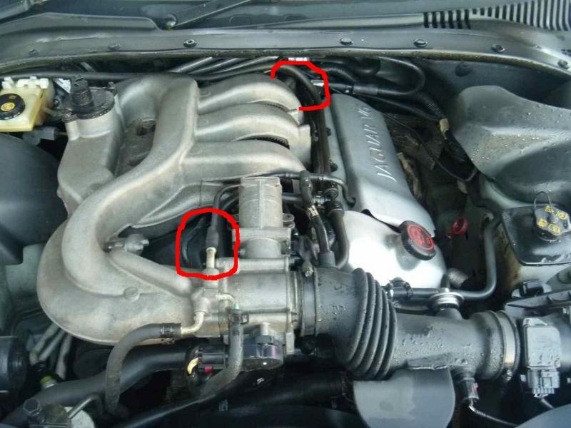

hi guys new member here registered on another jaguar forum but not getting any response to my questions so i thought id switch over.
my question is i need a vacuum/breather pipe for my 3.0 v6 s-stype.
the pipe goes from near the throttle body runs under the inlet manifold then goes ends,it then has an elbow on it going to a pipe sticking up behind the inlet manifold,i will try to upload a pic to show you
thanks in advance gav

You're as yet too new but otherwise could look in the FAQs which I suspect show you such things!
Old Mar 26, 2012 | 03:03 AM
I think that this thread will be of interest.
Vac Lines.
