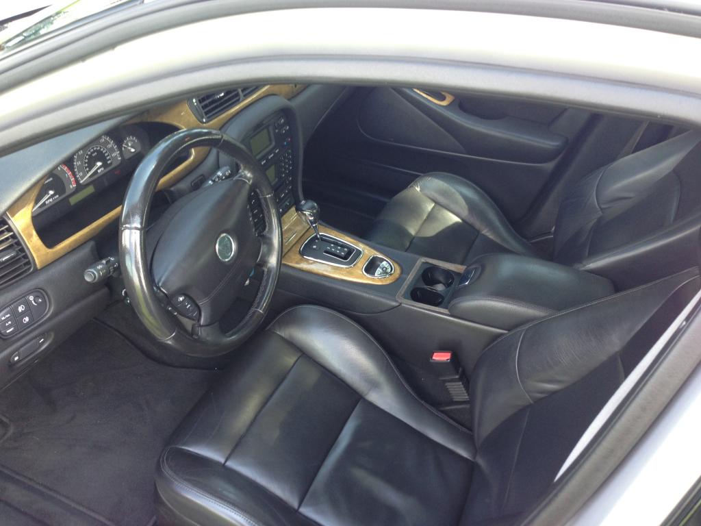

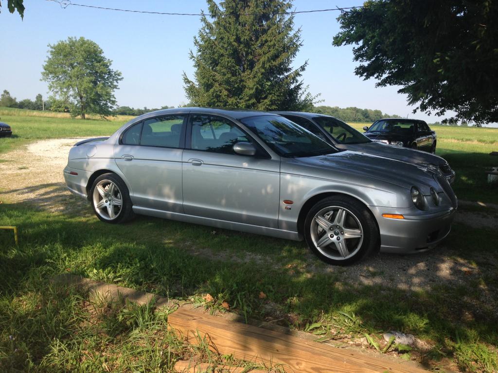

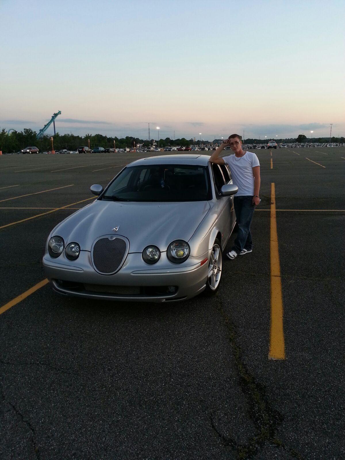

I'm sure there is more flaws, but I can't think of any at the moment. I've owned this car for about 2 1/2 weeks now I think its very clean inside and out for its age. I get so much attention/compliments. Pretty Sweet car aside from the issues I have noted "Oil".
I've already had a smartass come up to me asking me " Is that dads car your driving? " Pfft.

welcome to the forum, your car looks the same colour as mine.
