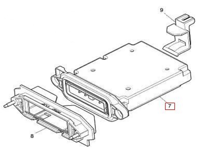

OK. One more swing:
There is a black sleeve that the ECM slides into. I can feel what seems to be a catch on the top of the sleeve, a square recess that I can feel with my finger. there is about a 5mm gap that I thought that when I depressed this that it would raise the catch to release the ECM. I tried to slide a plastic pry bar in to try to release the catch but to no avail.
Can you reveal the trick to release the catch? Is there a bolt(s) that retain it from the other side of the bulkhead/firewall? The retaining C-bracket is removed.

OK. One more swing:
As it stands, the only other system that I have not checked is the PATS signal from the instrument cluster, although I don't think that is it because no error codes are being displayed through the security lamp on the top cowl. Sans that, I don't see any other requirements that the ECM needs to ground the coil at the starter relay other that PATS, ignition switch and neutral safety switch.

I am into this conversation late so if I bring up something that has been covered please forgive me.
Have you checked the starter relay? If not seated properly could cause a problem. I would also check the clutch pedal safety switch. The starter relay also sends power signal to the engine control module. I would also check The 15a fuse in the primary junction fuse box, it provides power to the engine control module for the crank engine request. All are critical to the start. Make sure you have not overlooked the obvious.
Link http://www.jagrepair.com/images/Auto...x2052003en.pdf Page 47, Fig 2.1
Yes JagV8 is correct. As with a lot of the S-Type this is the updated 2003+ PCM diagram from the JEPC. The car in question is a 2003.
Different PCM and different mounts for the early 2000-2002 cars.
