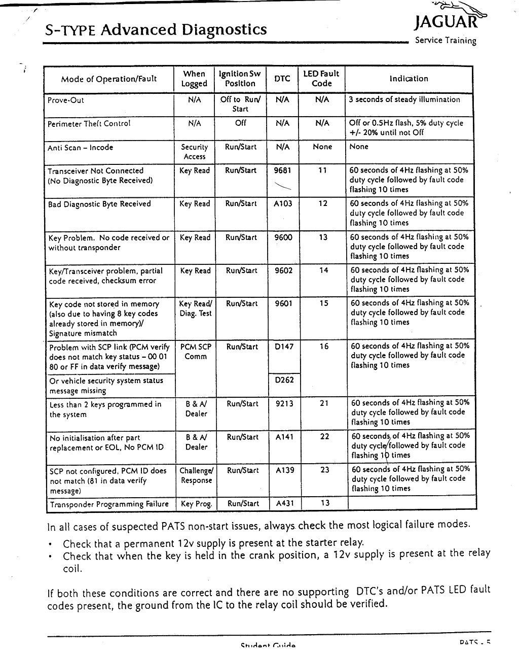

You need to read the PATS code and find out why the light is 'blinking'.
Here is a page from my Student Guide.
bob

The light is supposed to blink for 60 seconds AND THEN blink a code!!!!!!!!!!!!
60 seconds of 4 Hz flashing of 50% duty cycle followed by fault code flashing 10 times.
You are NOT watching it long enough.
bob
