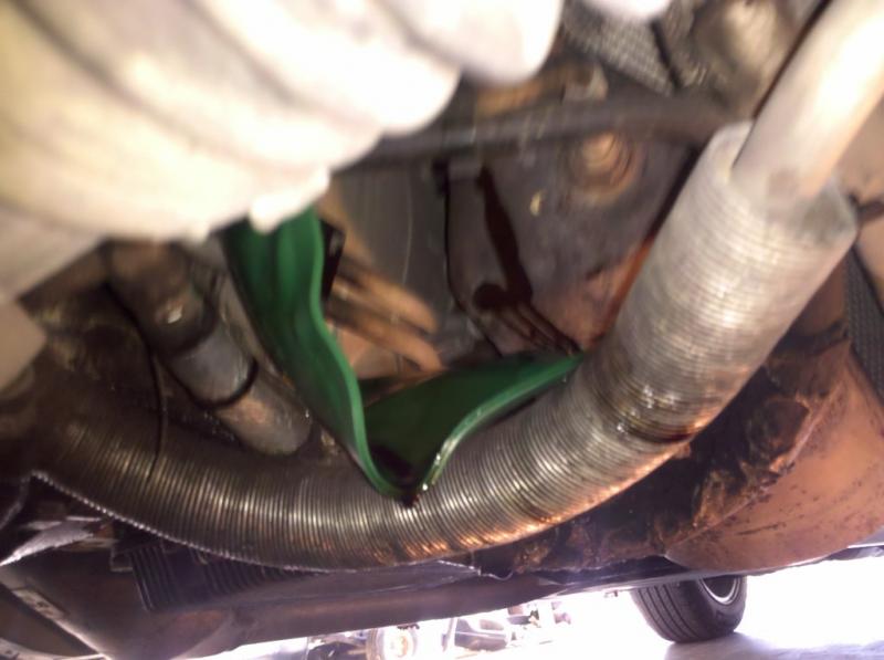

Daytona, you didn't just have an oil-change accomplished, did you? Very common for people to oil up the a/c lines when changing the filter and they have corrugated covers...hard to get them wiped down sufficiently not to drip for awhile after. Just a thought.
Flexible funnel comes in handy: (or wrap the lines with plastic wrap)
Attached Thumbnails Oil Drip -Any ideas-img_20130105_132743.jpg   Oil Drip -Any ideas-img_20130105_132828.jpg

Great pic's aholbro1! Naw got under it and wiped it down pretty good. In the middle of changing the IMT O rings now.
