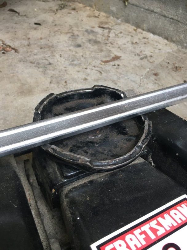

Here's the floor jack I use. The pad rotates, and has four recesses around the perimeter, kind of like a rook chess piece. By positioning the crossmember in opposite recesses, it fits very securely. I've set a silver tire iron across the jack pad in this picture, to explain what I mean:
As when using any floor jack, make sure the work surface is clean and smooth so the wheels can roll smoothly and adjust as the jack is raised.
