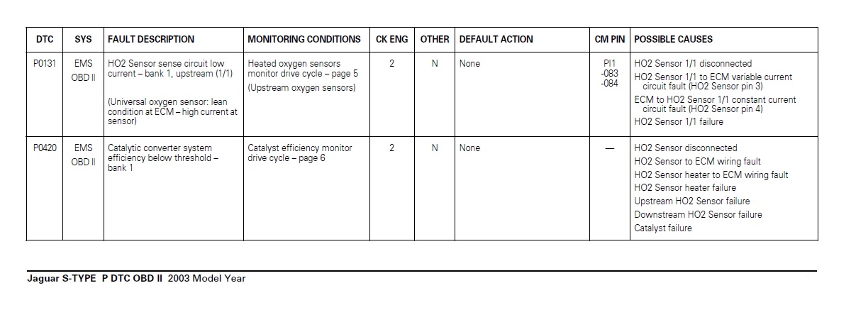

Originally Posted by Alleycat66
.............. Dealer says the bank 1 cat is gone and was likely fouled by the bank 1 misfire. Says the cat needs replacing, bank 1 coils, gaskets etc... $3141.00!!! .........
Did they arrive at this conclusion by assessing the vehicle or by assessing your ability / willingness to pay?
Whilst replacing the Cats and coils could well eradicate the issues, it's an extreme approach. It may be that the Cats are gone but logical troubleshooting would eradicate possible HO2 sensors and harness faults before drawing that conclusion.
.................. Dealer says coils, plugs, o2 sensors, bank 1 cat needs replacing. I kind of think that they just figure if they replace everything it should fix the problem. I don't really like that approach especially when it's my money.....................
I'm sure that's exactly the thinking behind their recommendation.
P0420 isn't exclusively the sign of a dead Cat. There are other possible causes:
It's always best to refer to the Jaguar DTC Summary for the complete list of causes. As you can see in the above extract, there's plenty of other things to check and eliminate.
