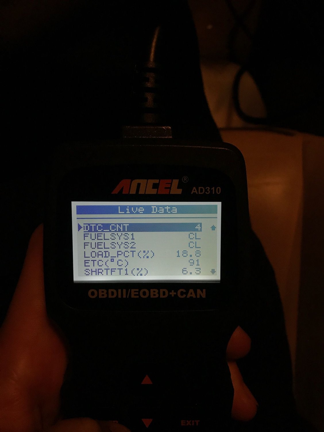

OBD live data can show you the LTFTs, which should be near zero at idle and not change much if you rev it to about 2500. The likes of an elm327 can do live data.

Live data can normally show with almost no cost and in effect zero effort and time that you do or do not have a leak. If you don't then smoke test is pointless.

Thank you all for the advice. So after a mishap , i was able to get the live data. See the photos but from what I looked up anything above 9 and below -9 is bad .. looks like im way past that lol

Go to the fifth post here https://www.jaguarforums.com/forum/s-type-s-type-r-supercharged-v8-x200-15/cant-seem-figure-out-misfires-codes-181227/#post1675852
tells you about your readings
