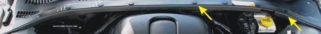

Good trouble shooting!! If you can hear the fan noise increase that is good. Because that means the ECM has commanded the fan to increase it's speed due to engine temperature. The warm AC is again the computer adjusting things because it thinks the engine is over heating.
So I think you have a air bubble in the coolant. Have you added any coolant or done any service to the cooling system? Do you know how to bleed the air out of the cooling system? Close to the brake master cylinder you need to look for a hose that just ends and on the end it has a slot for a screw driver.
In the attached picture the hose should be to the left of the yellow brake cylinder cap.
