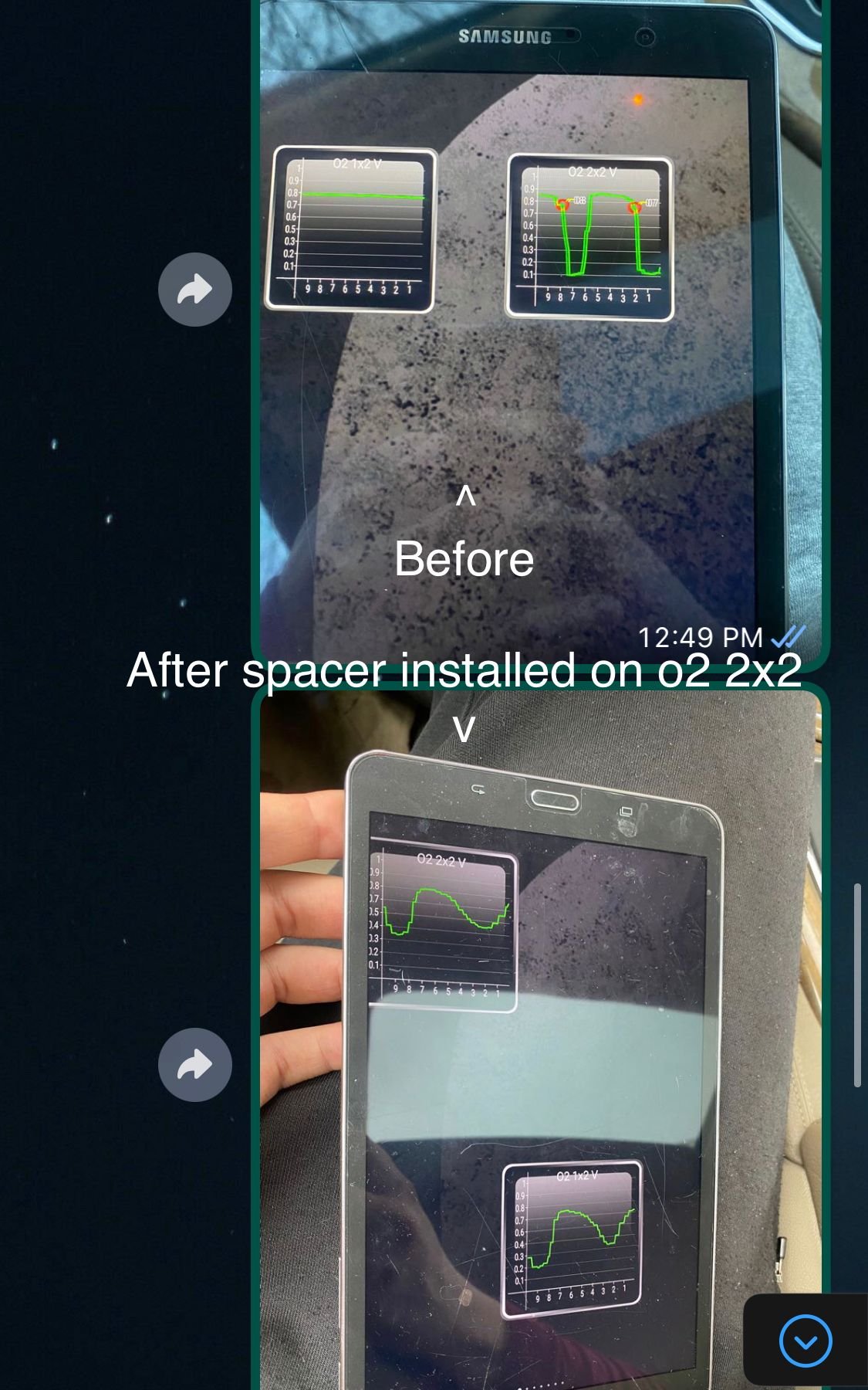

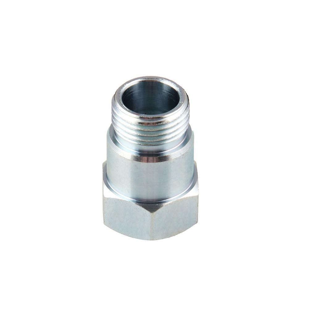

anyways, fixed the cat issue with the classic spacer fix. And i just to confirm it works on a v6 stype.
how:
A spark plug anti fouler drilled to a 0.5inch interior, or
my custom made 35mm tall spacer (pic below), M18 1.5 threads, 0.5inch interior,
was installed to move the probe away a bit.
thats it, $7.
check the before and after catalysts o2 sensors readings below.
if you pollute, please fix it correctly

yes, right allow me to add some quotes for the topic to me more specific:
from other forums:
"My understanding of this code (P0420) is that the cat is not functioning at OPTIMUM level (meaning less than 95% efficiency) and by the use of the secondary O2 sensor the computer is throwing off code P0420. Doesn't mean that the cat is no good, just not at 'OPTIMUM' level (95% or better)"
as proof, after the CO and HC tests, my cat appears to be working at a 93% efficiency. temperature tests passed too
and from 1aAuto blog, credits to them for the list that can cause p0430 and 0420:

right... yes, that's the side where coolant was entering the exhaust. might have poisoned the cat a little bit enough to shoot the code.
cats were removed and cleaned, but the burned residue will only be removed after diving a while.
i the meanwhile i dont want to damage my engine with bad fuel trim corrections.
jaguar didnt invent the catalytic convertor, nor the lambda probe, so im guessing general info could still apply.
and this is the exact point of this post:
IF a v6 (at least) s type is WHITHIN emissions, works WELL, but this readings are present, a Spacer might work.
Thank you for the patience. hope it helps someone as these cars are old and can have random issues.

I have the code. I tried the spark plug non fuller with drilled hole, but the o2 sensor 2 bank 2 is still fluctuating 0.2-0.7 at idle and throwing p0430. Should I try longer spacer ?
Old Aug 27, 2025 | 07:03 AM
elDariusVargas's Avatar
Joined: Sep 2021
Posts: 299
Likes: 40
From: Cluj-Napoca
Hi! I decated my jag and pulls way better
if you want to keep the cats, put some steel wool in between the sensor and fouler. Probably at this point your emissions suck, so why not decat?
same diameter pipe instead of the cats.
if inspection is a problem, get those cheap catalysts and install them obky for inspection, then remove them as those suck, they help you pass inspection but they drive bad and would only resist 6 months.
so plug and play only for inspection if needs be

yes your're right. I should have checked myself the manual first.
but i suppose they do like a maximul 0.something % correction... so fouling the downstreams would be fine. On mine after the decat, i just did some spacers with steel wool to keep them from shooting the error, but its done symmetrically if even if they apply corrections, they shall still be ballanced, as opposed to having a bad cat that will influence the trims
