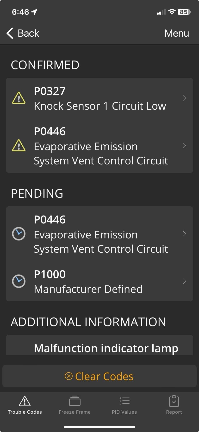

Jon89's beloved S Type has become the MagJag some years ago. I was driving home yesterday with Todd, Maggie's father when Maggie video phoned. S Type was a quarter tank full, Maggie attempted 2 pumps, when fueling gas would rush out of the fill port. A 3rd pump at different has station worked fine.
I know when GM trucks are "topped off" after the first full kick off, the carbon canister gums up causing this refuel problem.
I have searched here and of course Google, to no avail. I am turning the experts here for ideas.
I am not to concerned with the P0327.

I am just speaking of prior exp with the evap code in general. I have had that code on 2 gm vehicles. Replaced the vent and purge valve and cured it. The k sensor code is one i have never seen just go away. Usually needs sensor replacement or broken wire. If you have access to a scope you can rap on the block or near the sensor and see how it reacts on the scope

P0446
Possible Causes:
Fuel tank / EVAP canister atmospheric port: restricted, blocked
EVAP canister close valve failure (stuck closed)
DTC = EVAP canister close valve malfunction
Jaguar is calling the XR828437 a Purge Control Valve or Solenoid. I am guessing it is the CCV?
I see no other control valves in the EVAP circuit.
I would pull the hose off the valve and try to fill the tank.
