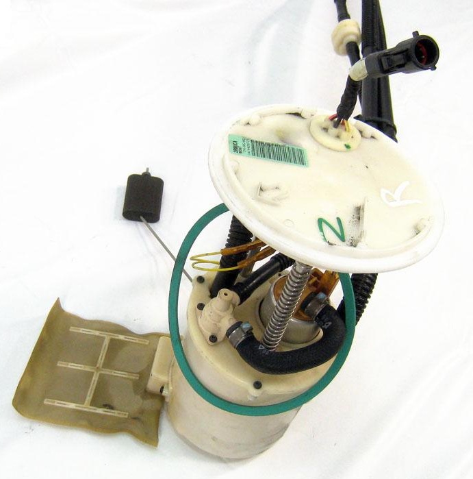

Here is a picture of one of the STR fuel pumps. Check that the hoses don't have any holes as this will allow the pump to suck air and not liquid. Maybe something is unhooked??
I can't remember if you got the JTIS or not but you really need it.
Attached Thumbnails Please help with fuel delivery issue-03 STR-2003-s-type-r-engine-fuel-jet-pump1.jpg

Wow - great pics!
It does sound like a pump or hose problem. The dash noise you can safely ignore (it's HVAC-related).
