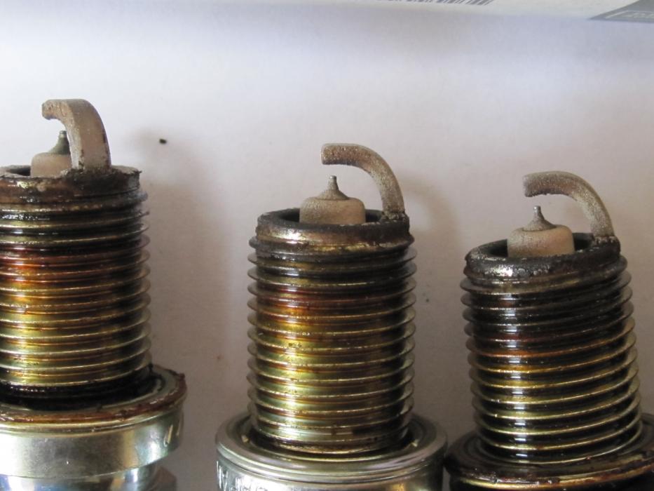

attached a few photos. What amazed me was the condition of the
originals which you'll see compared to the new. Jag specifies a gap
of .035 to .039; the old plugs gapped at .036...hardly any wear at
all.

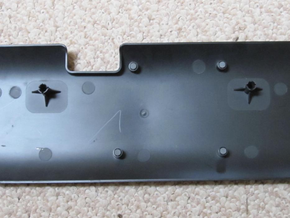

on the driver's side, put the fingers of both hands under the top of
the plug/coil cover and pull back quickly. Slide the cover (lots of
fun as the fuel line is in the way) forward and remove. On the
passenger side, place your fingers under the BOTTOM of the cover
and pull back. On each side the cover is held by two 'tabs' that
fit over stationary screws.
all.

When done installing the plugs, install the covers; you'll easily see
how they fit over the two screws. Push down on the cover, and all
is well. Install the engine cover. You're done. It took me about an

I thought I had a photo of old vs new. These are the old. The center
electrodes look exactly the same as the new. I think I'm sold on
Iridium plugs. You'll also notice that Jag uses an anti-seize compound
on the plugs. I can't emphasize the anti-seize compound enough. You
never, in this life, or any future life, want to deal with a plug that is
seized in an aluminum head. More often than not, if you are able to
remove the plug, the threads will be destroyed and even a heli-coil
won't save the head.

You can still gap iridiums it just has to be done properly. They should always be checked. My video from my youtube channel in my sig has a spark plug video and I go over the proper way to gap an iridium. Actually should gap all plug that way.
What should not be done is to buy a plug with a .060" spec and hope to get it down to say 0.28" gap. That results in a sloped ground electrode. Same thing with a .030" spec plug and trying for a .060" gap.
The 2nd and 3rd pictures are a good opportunity to see the effects of erosion.
Both the center and ground electrodes exhibit rounding of the original sharp edges.
Sharp edges promote better firing at low rpm. One of the reasons that the long life plugs use a fine center electrode is to combat the effects of this erosion. As can be seen, it is sucessful to some degree, but it is still there.
Thanks for the info! I wasn't even thinking that if you gapped them like shown in the article below it would work..
