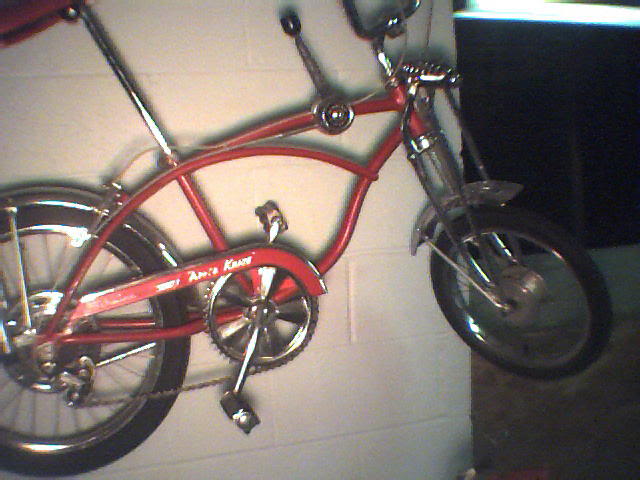

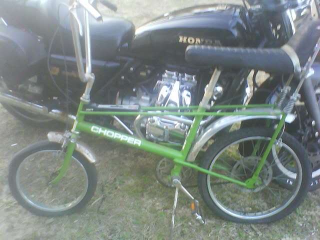

Back around 1969 my brother bought an Apple Krate, it was was so cool, I went to put one on payments and they were out, so I settled on a Raleigh Chopper, but I never got it paid off. My brother's Krate later got stolen, we found the guy that took it, and he had to buy my brother a replacement bike, since they had no Krates he ended up with a 3 speed Runabout, it was no way as cool as a Krate, but now they are almost as collectible.
My Chopper is a late Series one, lime green 3 speed, fairly decent original paint, nice pedals now, missing a hand grip, and tires are shot, small rip in seat but a good original bike. I also have a self assembled clone 69 Apple Krate, an original fair condition Orange Krate, a restored Lemon Peeler, and a repro 2006 Pea Picker, among other Stingrays, and an adult sized Schwinn Spoiler chopper.
A bunch of my bike and car pics Chuck Foster's (57charley)'s Library | Photobucket

Nice bikes. I have no idea what a Krate is, but your Chopper is the same as mine except mine was Orange. They re released the Chopper over here a few years ago, but it was a watered down version, no match for the original.
Some of the kids my age at the time, welded extra long forks to their Choppers, so they looked even more Easy Rider. With the weight balance changed by doing this, if you leaned back even an inch, the bike pulled a wheelie just before you feel off the back.
